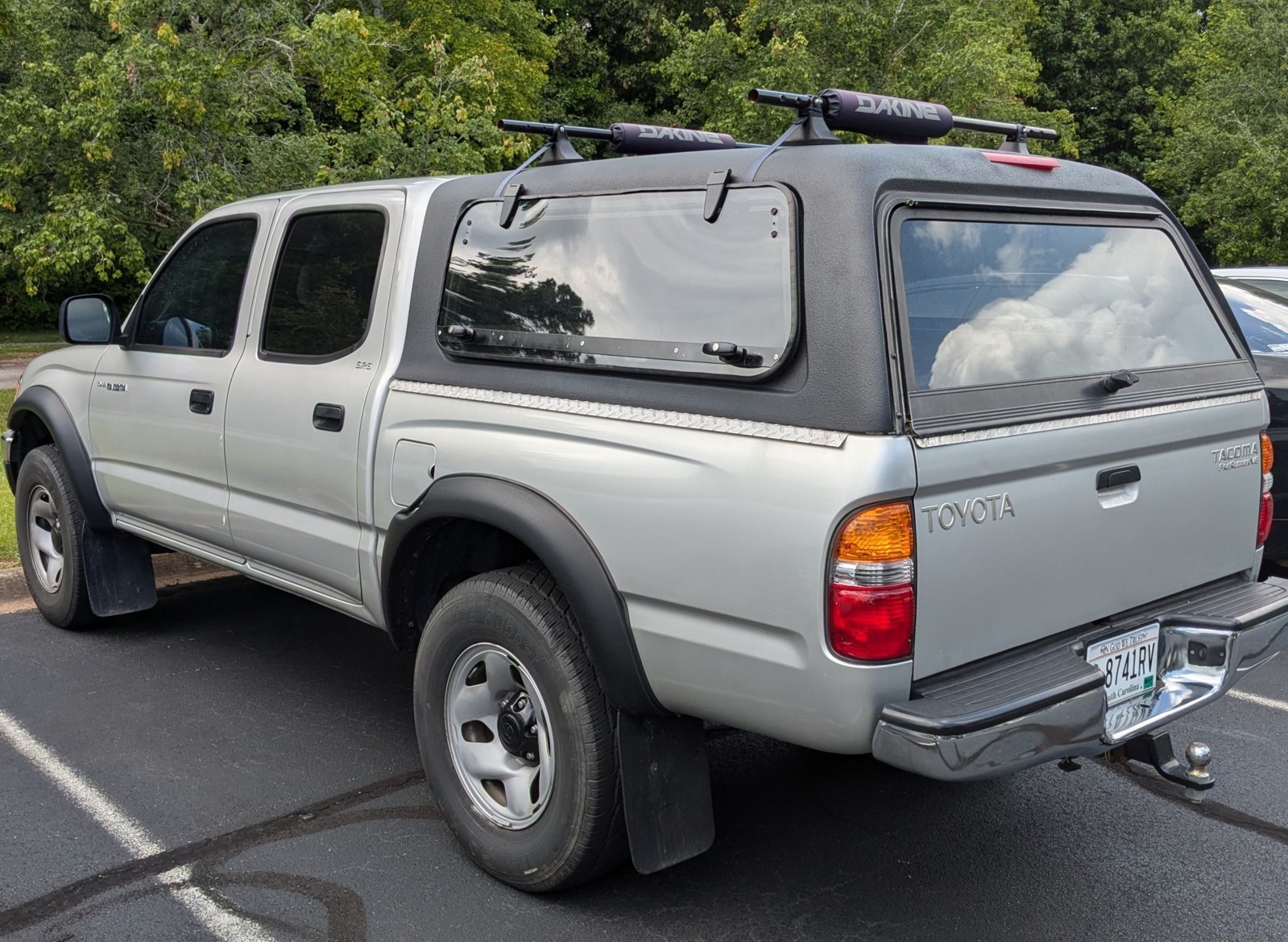

    Anyone know what backspacing these OEM wheels are? I'd like to get I different set but with the same backspacing
  19. Jul 17, 2024 at 5:46 PM
    #19
    jmag310
    jmag310 Member
    Jul 10, 2022
    #401104
    16
    2004 Tacoma 4x4 5 speed
    I stick with 16x8 et0 with 286/75-16
    Strider221 likes this.
  20. Jul 19, 2024 at 8:38 AM
    #20
    Strider221
    Strider221 Taco SuPremeRunner
    Feb 26, 2024
    #444687
    14
    Cody
    Greenwood, SC
    2001 Silver Crew Cab Tacoma PreRunner
    -Keyless Entry System -Alpine iLX-w670 -Camper Shell
    I decided to go with 16x7 oem steelies. My plan is to powder coat them white or grey. I'll post progress pics
