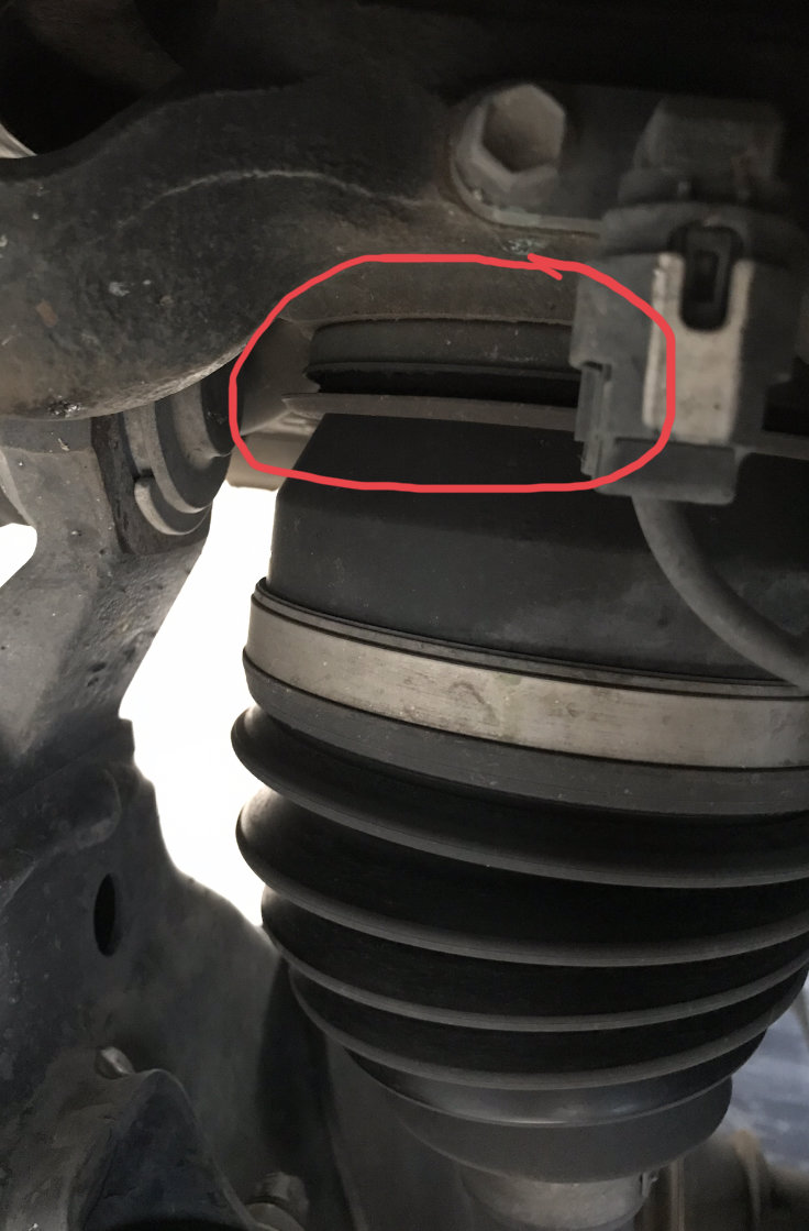

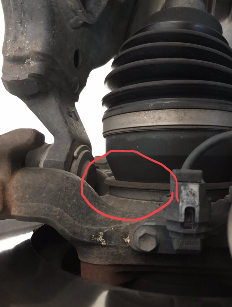

    I was looking at this situation this morning. I noticed a much larger gap on the PS than the DS between the end of the CV axle and the knuckle. Is this normal?
    DS:
    PS:
    If this isn’t normal, what would cause this?
    The PS, which I think is the one growling, has the larger gap and I don’t know why.

    looks like the seal didn't get seated all the way. But is it a problem?

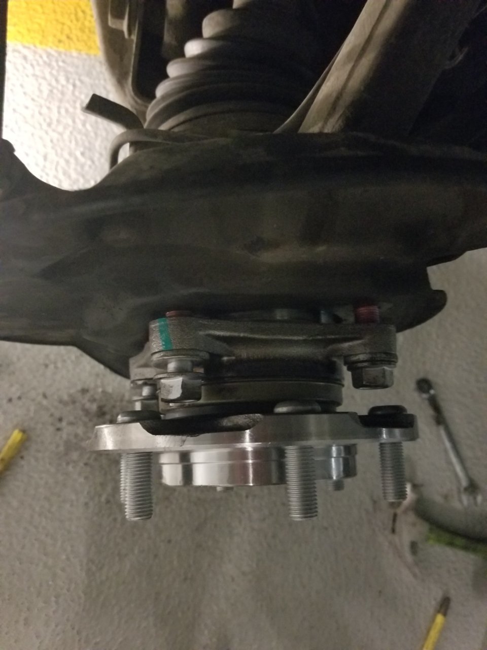

    I'm in the middle of my hub assembly replacement. I noticed one corner of the flange has a green mark on it. Do these have to be clocked to a certain direction?
    Assembly is a doorman 950-001 111
  18. Oct 31, 2020 at 12:42 PM
    #38
    Goosie0080
    Goosie0080 Well-Known Member
    Sep 11, 2019
    #305024
    345
    North East
    07 Tacoma Access Cab 4x4 base
    I don't think so. When I replaced mine with bluepitbearings, they didn't have any specified way of putting them on. I would place all the green lines on the same stud tho.. just to be safe. I can't see how that would matter much tho
