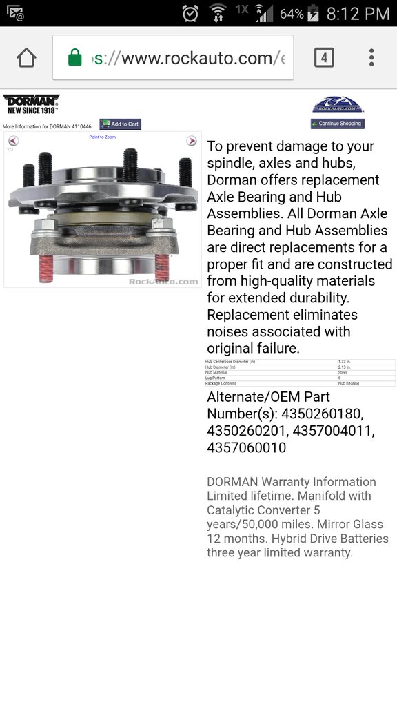

    Found a fully assembled Dorman Hub/Bearing p/n 4110446 for $135.99 from Rock Auto. Also got the Timken inner seal p/n 710573 for $7.81. Be here Thursday. Now just have to swing by the Dealershit for the CV Dust shield and O-Ring tomorrow:thumbsup:
