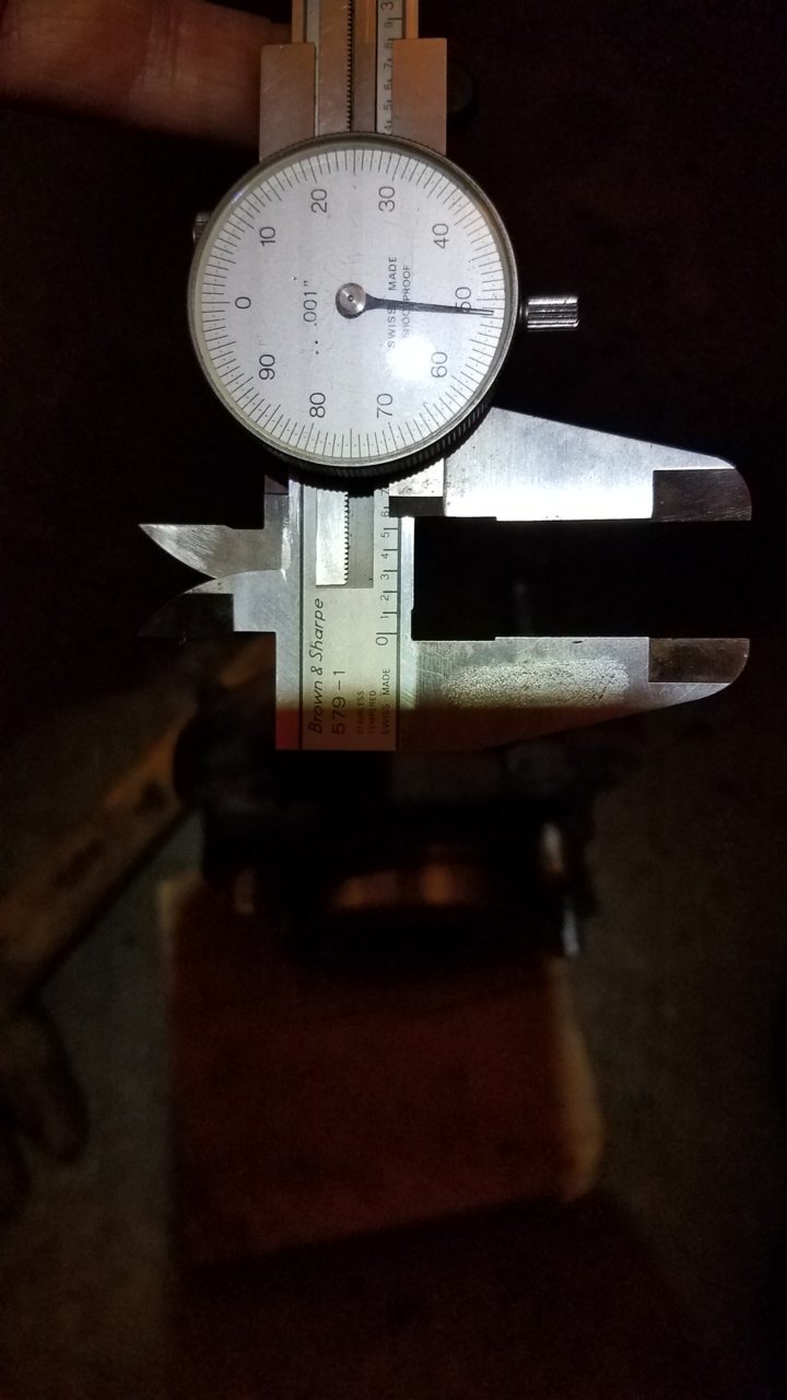

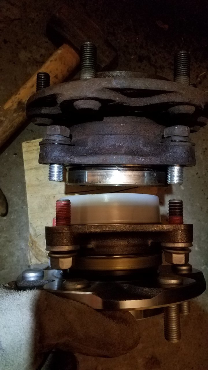

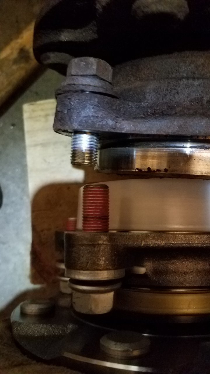

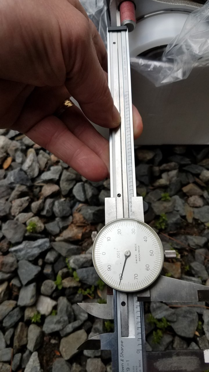

    Hi all. Hope you can help with this one. Trying to replace front wheel bearings on 2006 4x4 TRD. Local garage charged $600 back in 2011. Found several options for bearing hub combos and have purchase 2 separate sets to do it myself. First from Maxspeedingrods.com and now Carparts.com. In both cases the 4 trapped bolts are longer than the originals. The taps on the truck are blind (not thru hole) so the bolts bottom out well before they fasten the bearing assembly. The first time I thought China screwed up and that's why the combo was only $100 for both sides. But I just received the other set from Car Parts.com and the same issue? Am I overlooking something?
    The original bolts stick thru 0.55".
    The new ones 0.89"?
    See pix 20190424_221951.jpg 20190424_221938.jpg 20190424_222408.jpg 20190510_171757.jpg
    What the what?

    Looks like there are no lock washers on the new bolts. Could this be where the length discrepancy is?

    The washer and lock washer are there.
    The length of the new bolts stick thru 3/8" or 0.375" (~10mm) more than the originals.:confused:

    I've done wheel bearings on a 2008 4x4 and a 2010 4x4 and they both had bolts like your new hubs not like your old hub. Those bolts on your new hub w/washers look like factory bolts to me. Can we get a picture where the hubs mount I suspect that this is the problem not the hubs.

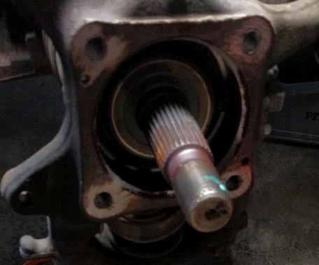

    It would be nice to crack this mystery though. Wish I took pics of the bearing assembly side of the knuckle when it was apart but did not.
    All looked as expected though. I cleaned up all the surfaces before reassembling and nothing seemed out of place.
    Here' a pic of the knuckle from the backside. Had to do a sanity check to make sure the taps really were blind and not thru-hole.
    Are some knuckles thicker? Where does all that extra bolt length go?

    Valid question and something that has me wondering if I should pull it back apart and re-evaluate.
    Check out the first pic in the thread. The Loctite shows how deep the bolt threaded before stopping. And it was a hard stop. Tried backing it out and trying again without advancement. However, I didn't try poking around in there or chacing it with a tap. Maybe time for that if no one else has experienced this same issue.

    A quick update on this. I gave up way too quick when trying to replace the drivers side bearing assembly. The one tap I tried had a burr and the garage that did the bearing last time used shorter bolts with 18mm heads.
    Ran a tap in there and all was good to go. Both bearing hub assemblies replaced for $100 delivered! We shall see how long they last. Thank you for those who repled with helpful info. Mike
