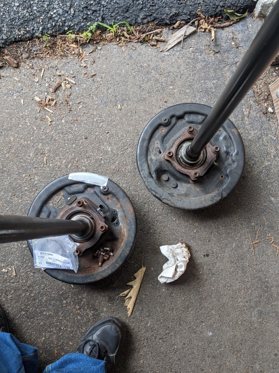

    I’d like to to hear how everything turned out. My own 2012 4wd has a hum coming out of the front end that goes away when the steering wheel is turned to the right when driving. Changed the passenger side WB assembly and ... still there. Any suggestions?

    Zoom in on my pic. The axle on the right was the source of my droning sound. It was rubbing up against the wheel speed sensor.
