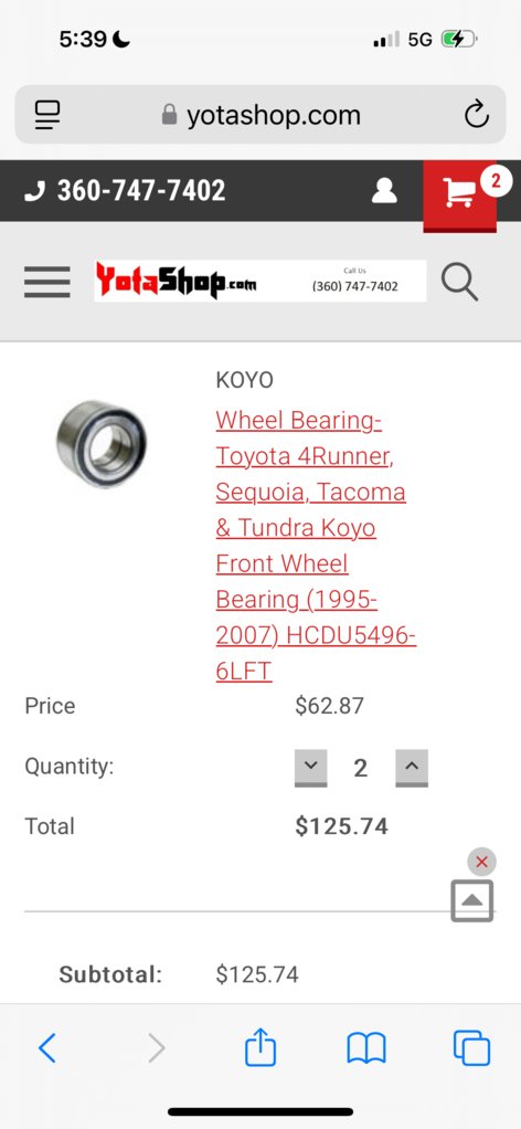

    OP will dislike SET29 as it cost more than the one I suggested, Koyo Made in Japan. $62.87 vs $79.79

    02hilux,
    The KOYO DU5496-6 bearing being sold by Yota Shop is even better than just a low price. Info direct from KOYO JAPAN: The KOYO DU5496-6LFT front wheel bearing is a new design with 2 additional internal rollers AND a new low torque seal. Bottom line: The new KOYO DU5496-6LFT bearing is the new standard for front wheel bearings on our first gen Tacos AND Yota Shop has a killer price on them. I just replaced both my FWBs with OEM Toyota FWBs which were actually the old design KOYO DU5496-5 bearings in Toyota packaging. Next time, I will be using the new design KOYO -6LFT bearings. In all likelihood, Toyota will be selling and installing the old design OEM/KOYO DU5496-5 FWB until they are out of stock. HTH

    Koyo FTW but apparently it’s not good enough somehow…..

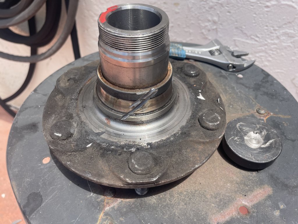

    1. Nothing wrong with the old hubs yet as I still haven't pulled the old race off yet.IMG_3779.jpg
    I didn't have to stop the bearing job and do this since I had new hubs. $30 a piece from Rock Auto.
    2. Not everyone is at the same tech level as seasoned mechanics or persons such as yourself and others. Being 70 years old I'm also twice as slow.
    3. I lent out my large bearing splitter and it came back missing all the nuts, bolts and crossbar. My smaller set is too small.
    Did you cut off the old race as I'm in the process of doing? Please explain your method for my education. Thanks in advance...!!!

    I don't know if the hubs on the 2wd trucks are different (doubt it) but I pressed the hub out of the bearing with a press... not sure how you ended up with the inner race of the bearing...

    FWIW, I’m pretty sure those are advertised as -6 but are actually -5. The -6 are actually about $125 each. 90369-54002, KOYO no longer exists and is rebranded by its parent company JTEKT. They are consolidating.
    They sell the -5 at $65ish plus shipping 90369-54001 and the -6 at $125ish plus shipping 90369-54002.

    Shit bolted onto other shit, and junk.
    They split all the time. The inner race getting stuck is very common. I don’t recommend cutting it off. Invert the hub and suspend with metal plates then hit it with MAPP gas. It will expand enough to drop off. Otherwise I use a bearing splitter to pull it off, probably the same one @Rob MacRuger is missing parts.

    Map gas I have, thank you. :bowdown:
