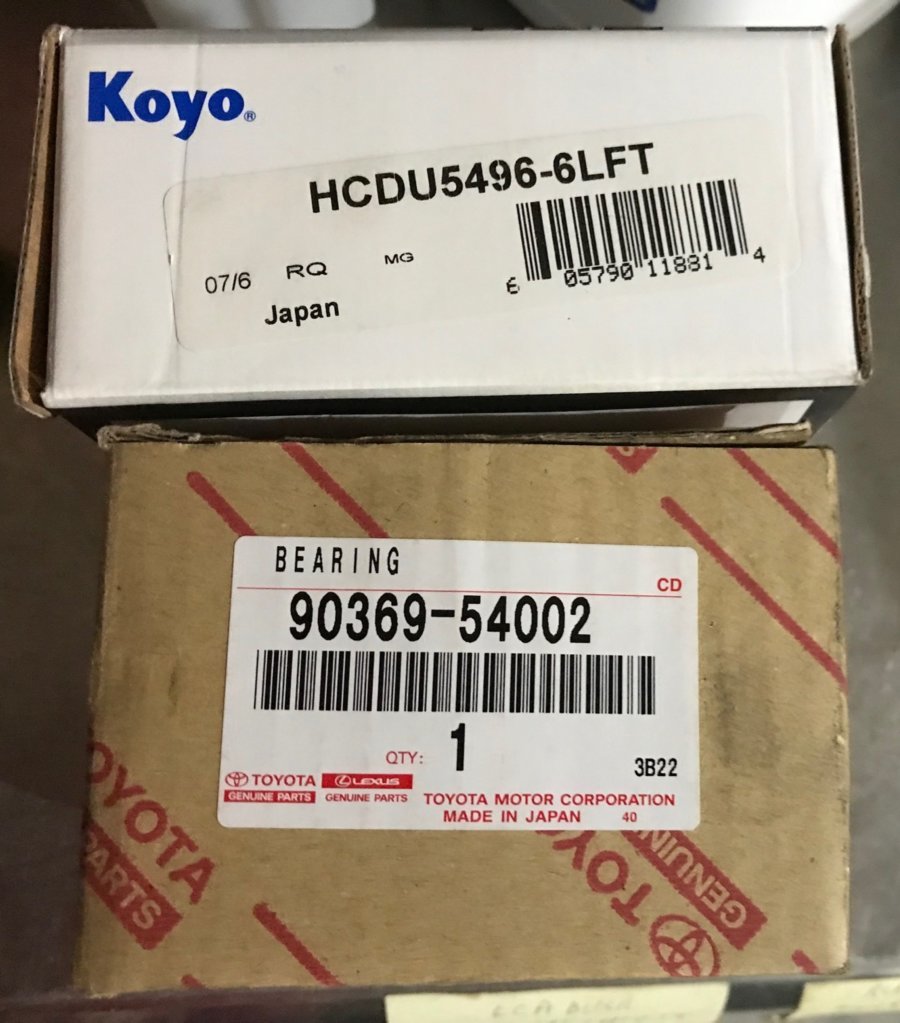

    Something I found strange about the new design KOYO DU5496-6LFT front wheel bearing is that the bearing itself is still marked with the old -5 number. Same thing with the newer design OEM Toyota 90369-54002 FWB (below). When I checked that out with KOYO/JTEKT, they stated that the new design KOYO DU5496-6LFT FWB itself will still be marked with the old -5 bearing number and that the box will be marked as the new design -6LFT bearing (below). KOYO/JTEKT also stated that the same grease was used in both the older and newer design DU5496-5 marked bearings.

    Damn!!! Plot twist. Good to know.
