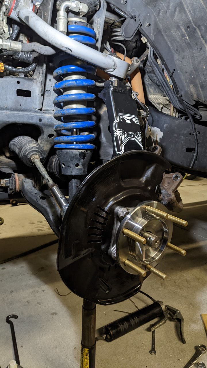

    I used my impact.
    But I used this setup to torque it.
    You could do the same to remove it. (go the other direction) , or pull the center cap off the wheel, put the wheel back on and rest the truck on the ground. But that’s a lot of work.
