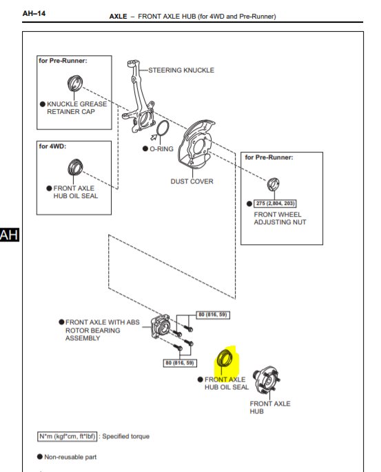

    There is still the same seal of the bearing to the outer portion of the knuckle no?
    Turtle7117[OP] likes this.

    I don’t know for sure, but it seems like there is a metal filler plate on the rear of the spindle.
    I don’t think there is any reason to take it off or out.
    I’ll have to look into it.

    yes that's where the CV axle goes, it's not a seal but a dust cover. Where the bearing gets set into the "hub assembly" of the prerunner there is still a seal, much like they get pressed into the hub assembly of the 4x4.

    I have to imagine these are the same seals.
    4x4 and pre-runner list them on the same diagram

    There looks to be just the 1 seal.
    And it goes in when you build the hub?
    ohcaltexscar and Jimmyh like this.

    Yeah, if you buy the hub assembly.
    You shouldn’t need it. It’s already in there.

    for sure, if you get a pre-assembled hub/bearing assembly. I'd still replace the o-ring, but no new "seals" are necessary.
