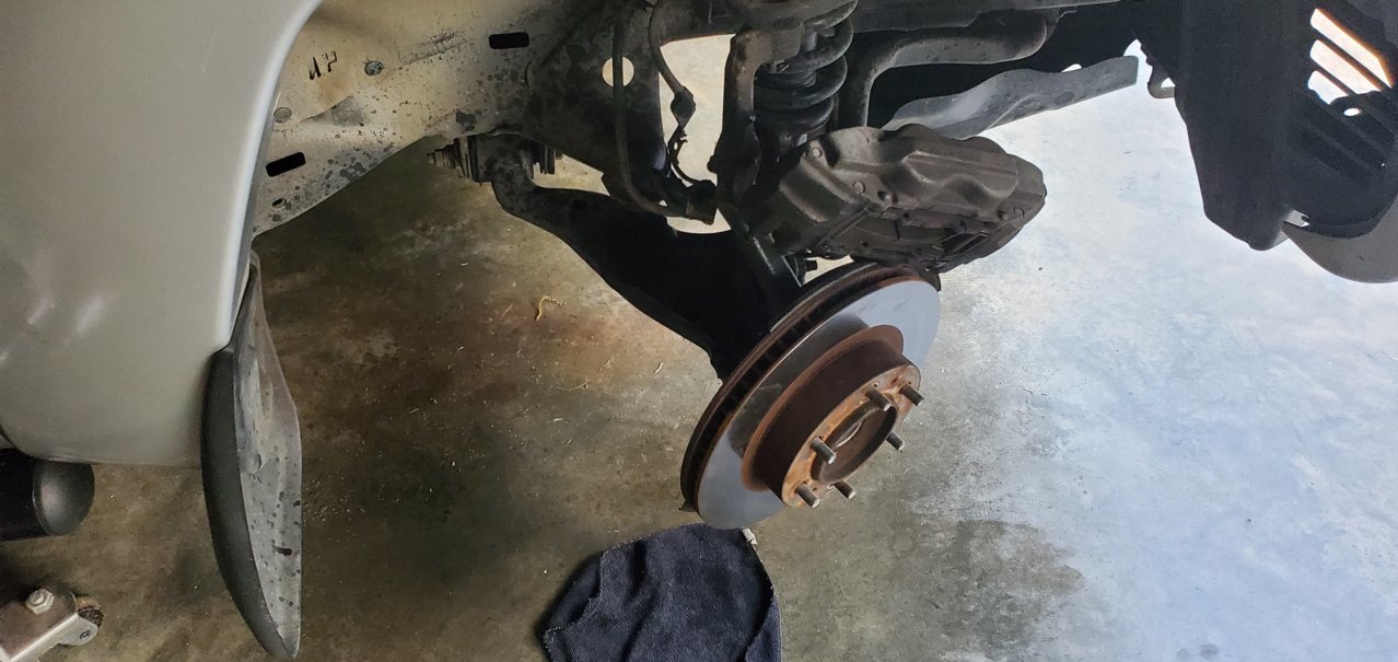

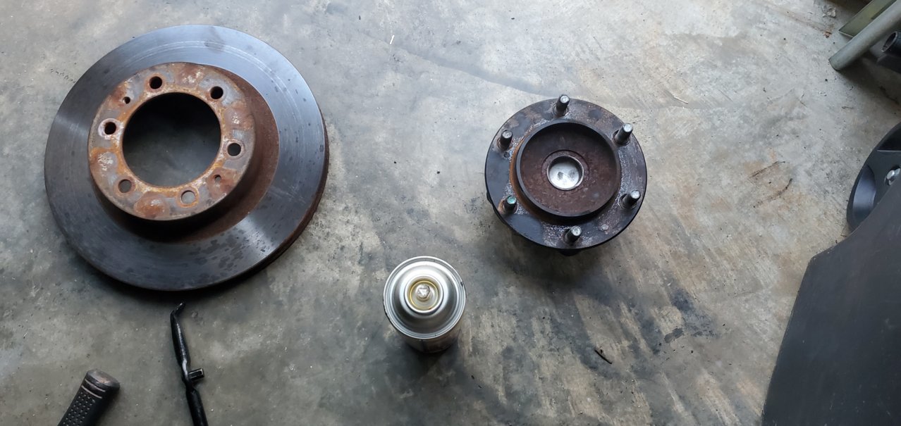

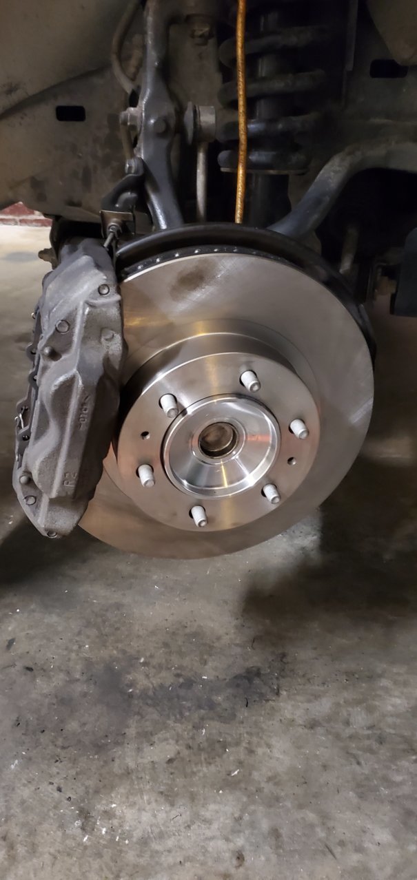

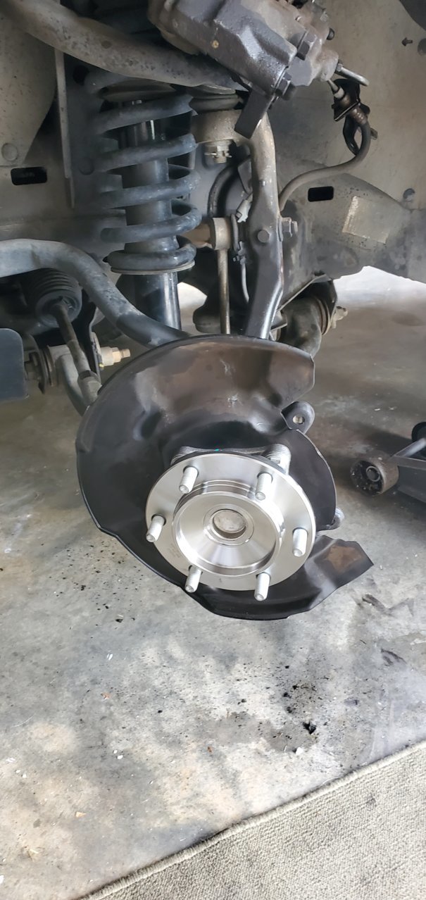

  8. Apr 24, 2022 at 6:11 AM
    #28
    GibbsTacoma
    GibbsTacoma [OP] Well-Known Member
    Dec 17, 2017
    #238715
    258
    Charlotte Metro Area
    2010 Tacoma TRD Sport DCSB 2wd
    Finally got it installed. The passenger bearing had some movement so it was good to change. The driver's was still good but I changed it anyway for piece of mind. I also changed the rotors.
    There is somewhat improvement but the tires are vibrating at mid speeds. I'm going to look into the tires next.
