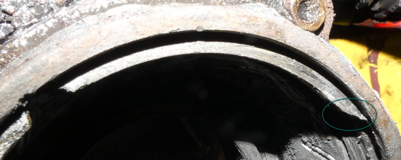

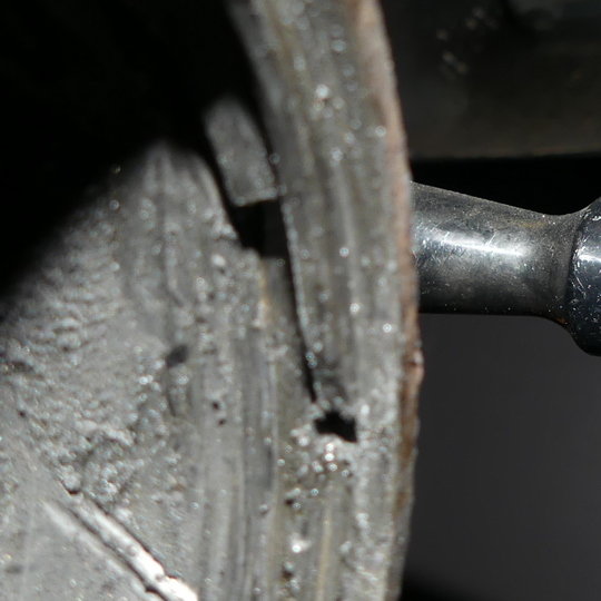

    Finally back. Having a hard time getting pics that show the mushrooming. Soooo, the end with where the ear is supposed to be I cannot get any tool behind/under it. I tried grabbing it with some vice grips & whilst pulling straight out, wiggling it a little. No luck. I even managed to cut a piece of the race out right next to it. Didn't help.
    I cannot fit any pick next to where the notch is.

    For what it's worth....

    We have super heavy duty snap ring pliers for these.. a hammer and screwdriver/chisel usually will break it free
    Kristi with a K[OP] likes this.

    Next one get the snap ring broke free before trying to get it out
    First move is getting the Snap Ring broke loose .
    If the eyes snapped off even the best snap ring pliers would have been no help
    I have some concerns about the bore of the steering knuckle .
