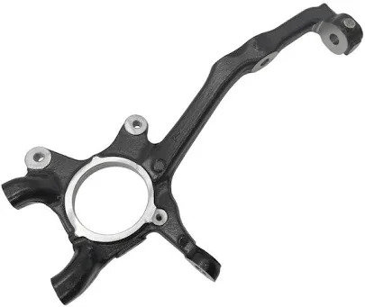

    Is the knuckle the end of the cv axle under the cap?

    Thanks! I’ve done a lot of PM jobs and replaced the CV once. With each new thing it is a new thing to learn. Couldn't have done more than an oil change without TW!

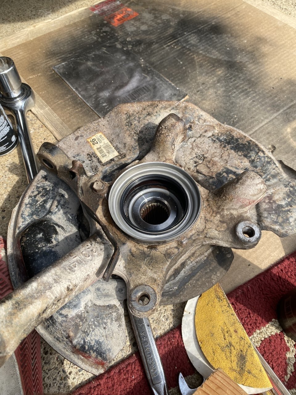

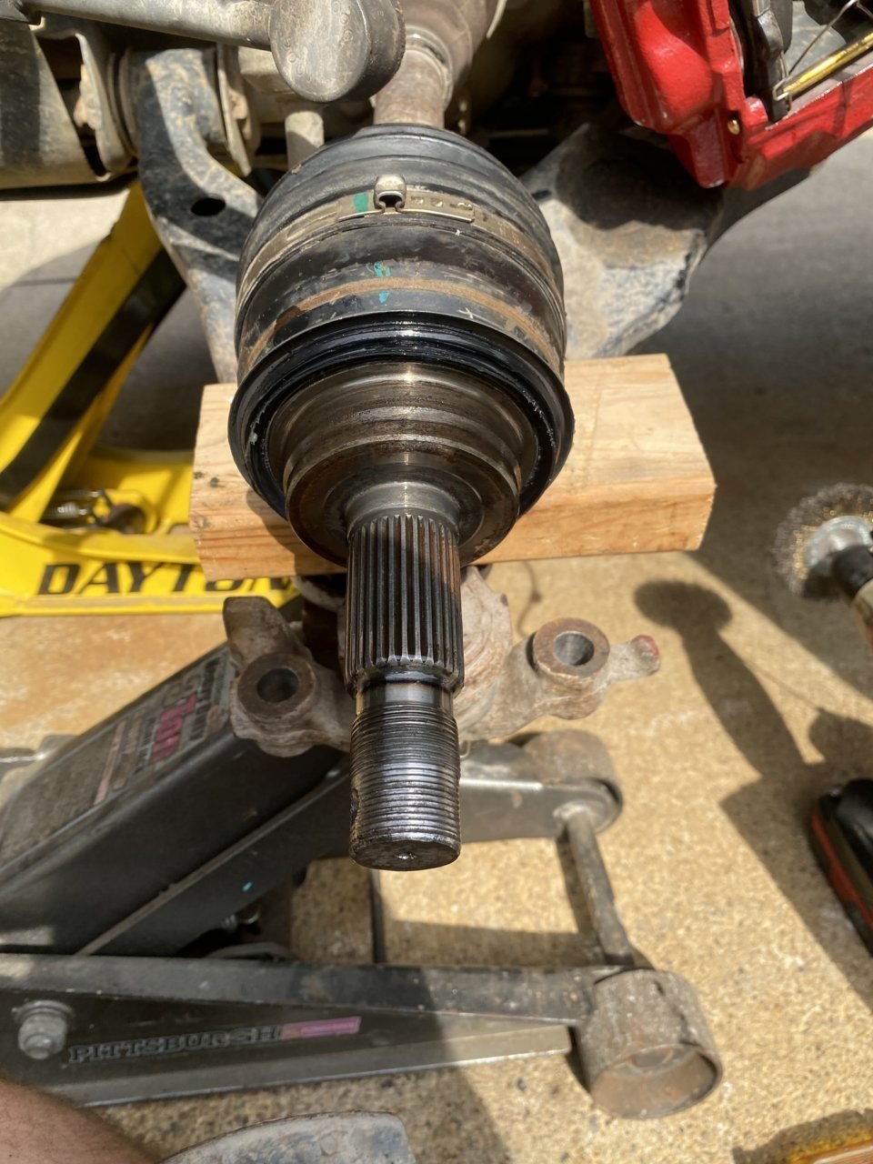

    My truck developed a similar noise and it ended up being the dust seal that goes on the axle rubbing the dust seal on the spindle. At some point, the one got bent slightly and started rubbing.
