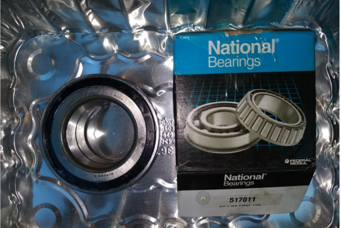

  12. Dec 15, 2019 at 2:02 PM
    CS_AR
    CS_AR Well-Known Member
    Apr 3, 2019
    #289019
    12,920
    1999 Tacoma PreRunner TRD
    Everything but the driveshaft. B03A - 410
    Thanks for the info. DING DING DING we have a pattern going here. Nationals are also reboxed Koyo as well.
    Which underscores connection between Beck Arnley and National. Both are owned by parent company Tenneco/Federal Mogul that is a Toyota OEM parts supplier. I've found National seals to also be reboxed OEM.
    Federal Receives Toyota Supplier Award
    Once you learn the relationships and how to identify the reboxed OEM products that are available at RockAuto.com you can go with quality parts and save a bunch of money.
    http://fmmotorparts.mediaroom.com/2...otorparts-Receives-Supplier-Award-from-Toyota

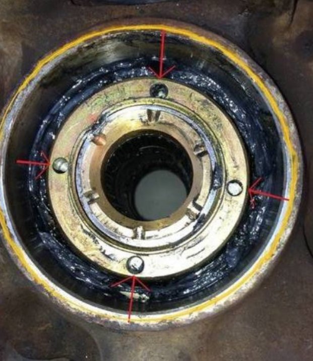

  14. Dec 15, 2019 at 2:34 PM
    CS_AR
    Apr 3, 2019
    #289019
    12,920
    Yep. From this picture, looks like the manual hubs have an additional bushing.
    Speedytech7 likes this.
  15. Dec 15, 2019 at 4:43 PM
    Floridaze
    Floridaze Well-Known Member
    Sep 2, 2019
    #304011
    71
    Pensacola
    97 ext cab 4wd
    Abs delete, lspv delete, led headlights, 5 speed swap, ome 882 nitrochargers and dakars
    That’s a nut. You’ll need a socket with pins to fit that. I ordered one off of Amazon ~$20. If you’re doing the press work be sure not to booger up those brass bushings that the cv joint rides on. If a machine shop is doing the work remind them not to
