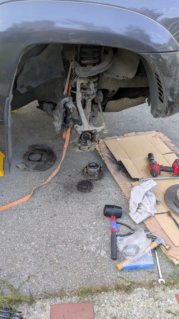

    Over the past few months the wheel bearing whirring sound has been getting worse in my truck. There's also vibration coming through the steering wheel, floor boards and truck in general.
    Of note: when I make higher speed or sharper right turns, the sound and vibration almost disappear completely. When I make left turns the sound is pretty consistent with straight line driving. This led me to the diagnosis of the front passenger side wheel bearing needing to be replaced.
    I swapped out the front passenger side wheel bearing assembly with an SKF brand assembly that I bought online.
    Took it for a test drive and the sound is still there!
    Now I'm trying to figure out if it's the rear passenger side or if I should just replace the front driver side too. I'm going to put it up on jack stands tomorrow and test all 4 sides for play and vibration/noise while spinning the wheels. Looking for any advice on diagnosing which wheel bearing is in the worst shape and curious if anyone else has had issues with thinking they were replacing the bunk bearing only to realize it's a different one making the noise.
    In hindsight I probably should've jacked it up and tested both front wheels for play and roughness/vibration while spinning before deciding which side to replace.
