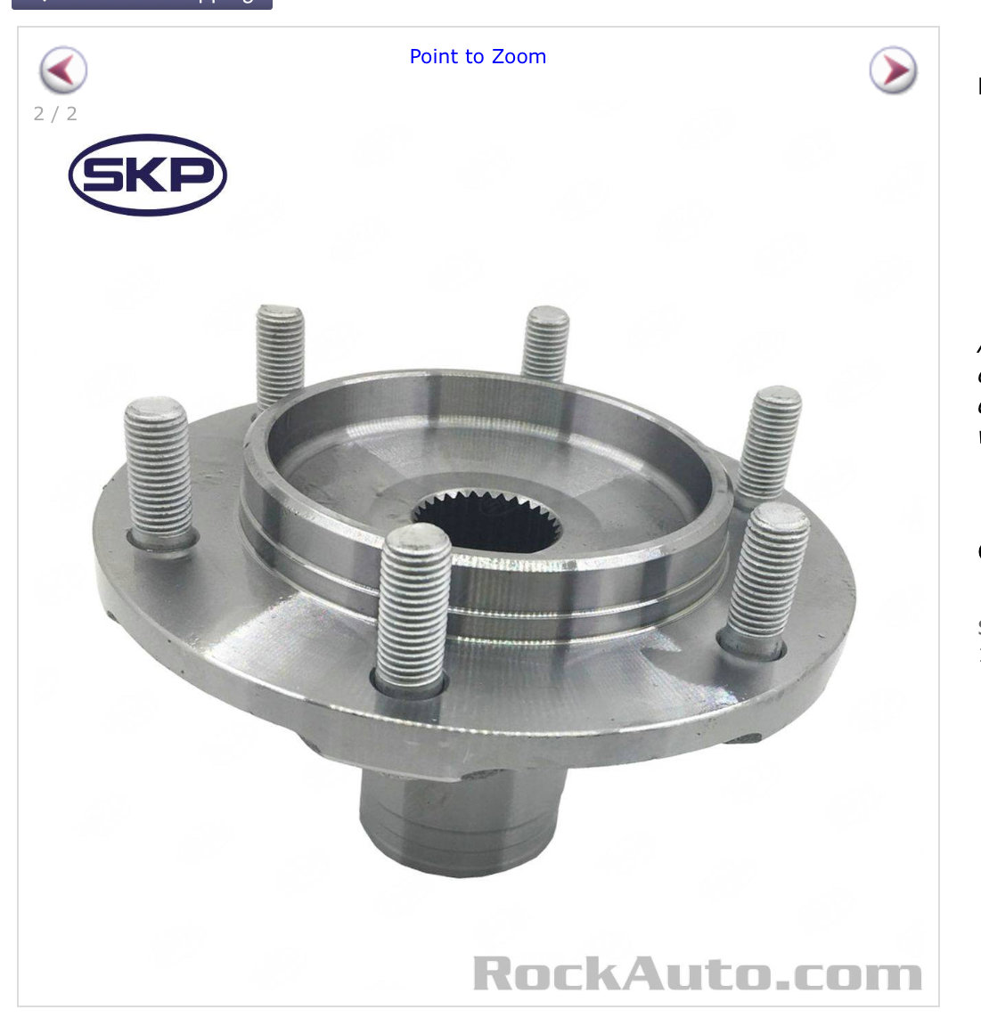

    Does the package come with Koyo or SKF bearings?
    If not, NO.
    The hubs are cheap.
    Like $35 apiece.
    Just buy them and take them to the shop doing the press work.
    This is the hub. The hub doesn’t come with any bearing.

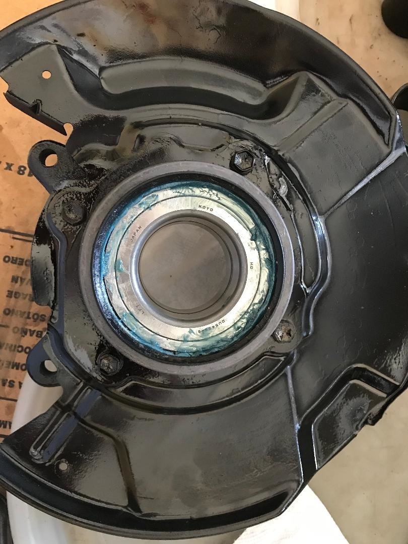

    Glad you got it all worked out inexpensively. That $1720 Stealership price on doing this job would hurt too much. $60 a side to press the bearing and hub together is a good deal. Just be very sure that the machine shop presses the bearing into the knuckle with the correct orientation. The shiny metal side of the KOYO DU5496-5 bearing faces outward toward the hub (below). The last full-time repair shop that pressed mine installed both KOYO bearings in the knuckle backwards. As such, there was no way to apply much less maintain the proper amount of preload on the bearing so both FW bearings failed in just 3 years. I finally set up a 20-ton HF shop press on HD casters to do my own presswork once again so can verify that it takes many tons of pressure to press these bearings/hubs in and out.

    Ugh^^^^
    Had a shop press a Honda bearing in backwards
    ABS lite would not turn off after repairs completed
    Tech didn’t know that one side of bearing is magnetic (to communicate speed to ABS computer)
