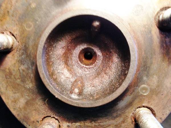

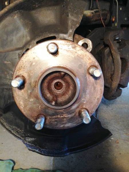

    I have a 2009 Tacoma 4X2 that needs front wheel bearings. The configuration that I have on my truck does not seem to match any I have seen on this site. They don't look like the bolt-on assemblies I have seen here. The hole in the center of the hub is M8 & threaded. Any help greatly appreciated!
    Here are some pix:

    You have a 5 lug. They are completely different. You have to remove the entire hub assembly and then there is a 36mm nut behind the cover on the back side. Then the axle is pressed out of the hub assembly.
    Send me a PM with your email address and I'll send you a copy of the PDF from a 2006 which should be nearly the exact same as yours.
