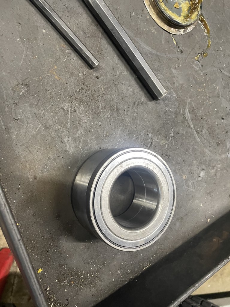

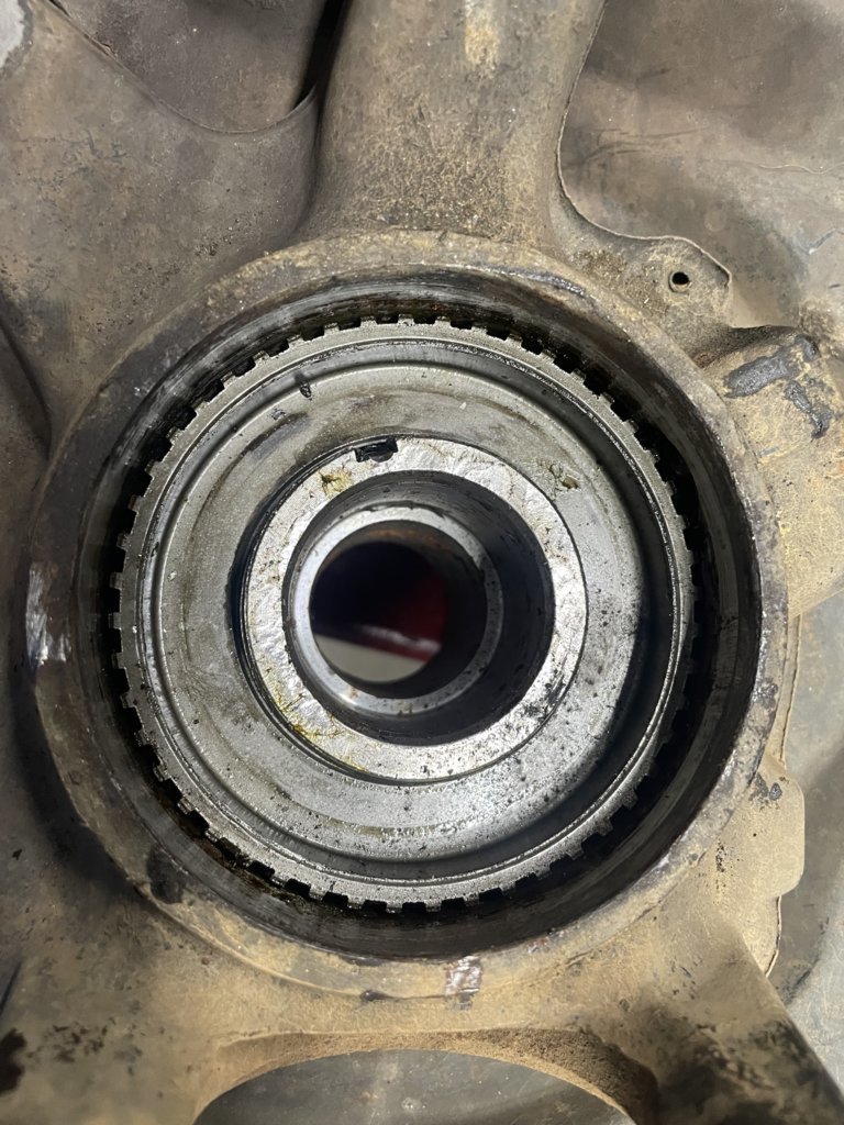

    Unfortunately, these are the only 2 pictures I have and, the tone ring is in the way. What’s on the left is what’s currently there (no part number available). The picture on the right is part number 90369-54002, which is gigantic compared to the existing one; and, is supposedly too big to fit in the knuckle.

    I’m not the first owner. I have no clue if the last 2 owners did something funky. But, the picture on the right is what the shop ordered ( I believe from Napa). The part number from Toyota pulls up the exact same part wherever I look. So, that supposedly IS the right part. But, it’s not what’s been in the truck for the last however many years.

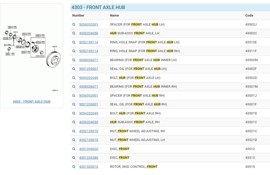

    Once you do that, you'll see something like this -
    Now, click on the 2nd tab (SEARCH) and type in:
    4303 - FRONT AXLE HUB
    You should now have this on your screen, there are your part#s
    For what it's worth, yes - both 6 lug 2WD and 4WD tacos use the same wheel bearing. 90080-36071 which has been discontinued and replaced with:
    90369-54002
