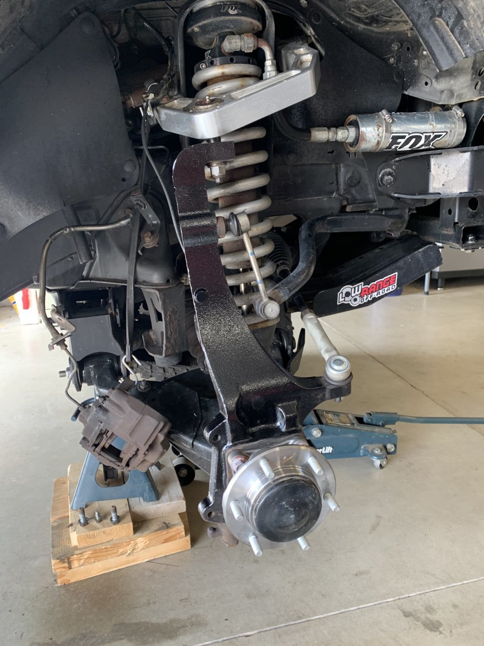

    18C6669D-9CFC-4B2B-B60B-E7E911E1DB19.jpg Absolutely great set of hubs/bearings. Thank you again truck has never driven/sounded this good great finish to my full front end rebuild.
