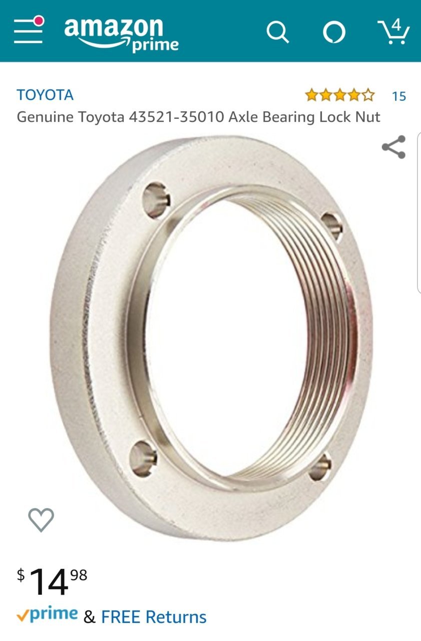

    I would also suggest buying new bearing lock nuts.

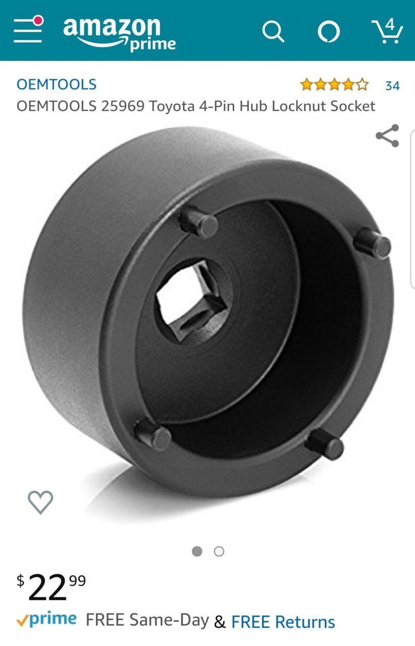

    And you will need a bearing lock nut tool.
