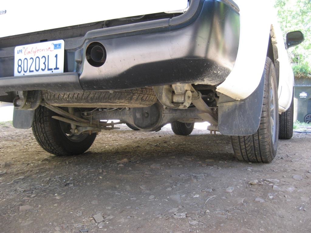

    On my 5 lug, I went from 215/70/15 to 235/60/16 to compensate for the larger rim size with a lower aspect ratio tire so as to keep the wheel diameter to within 1% of the original factory diameter.
