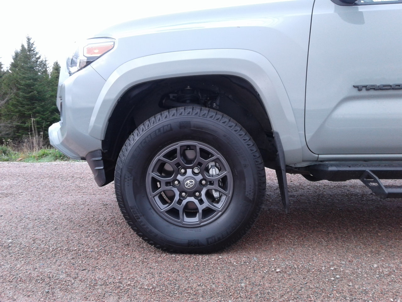

    I picked up a set of 16x7 OEM wheels on kijiji20221113_113941.jpg 20221113_113922.jpg from a 2017 SR5 and mounted Michelin X-Ice 265-70-16s with cloned Autel sensors.

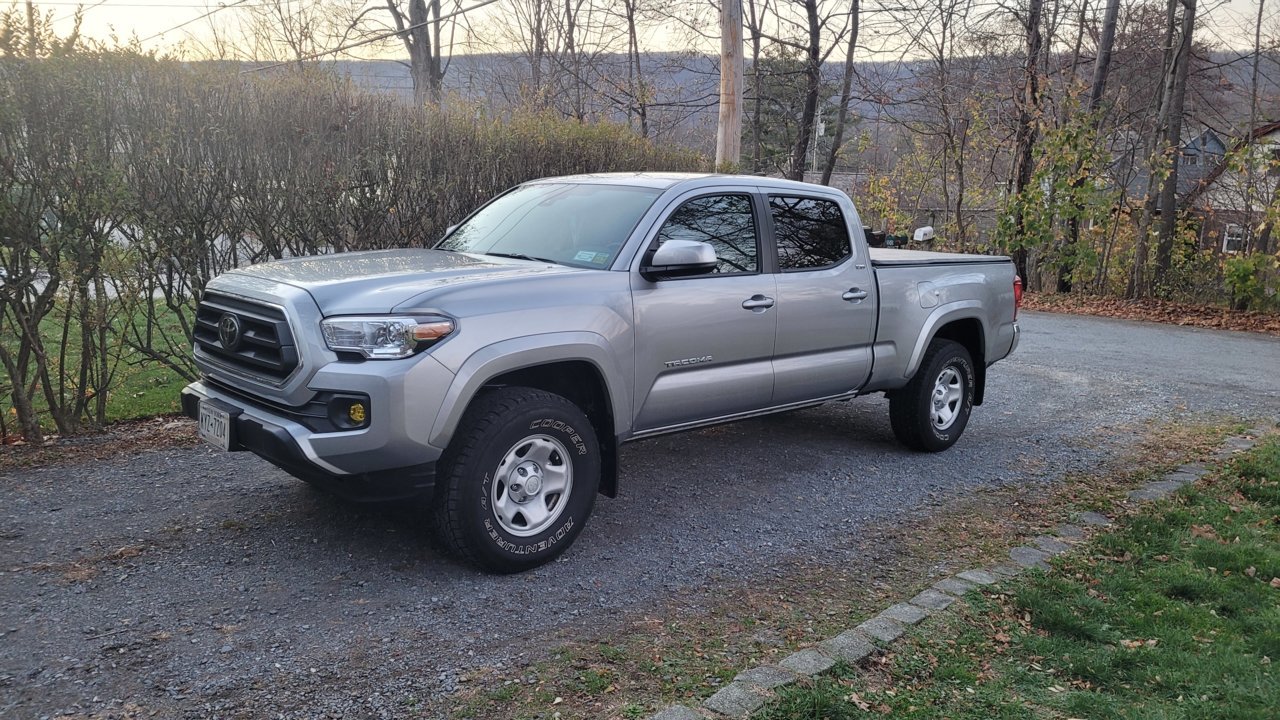

    2nd Gen steelies can often be found cheap from someone who upgraded. I found a set with good 265/75 /16 Cooper AT's on them locally for $100. Probably going to run them as is this winter and go with real snows next winter. They clear just fine BTW.
