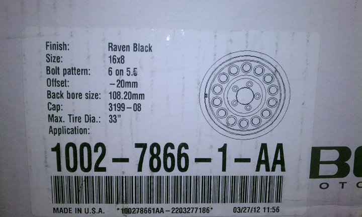

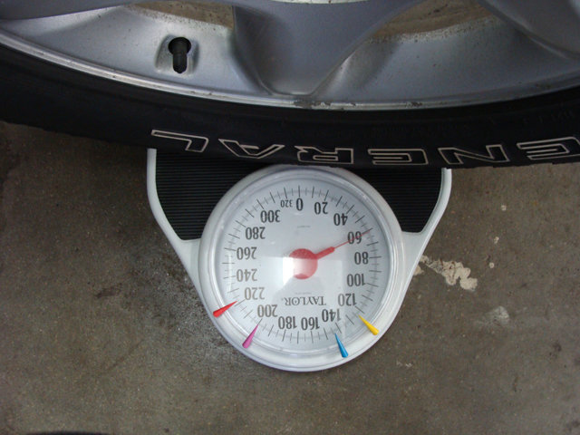

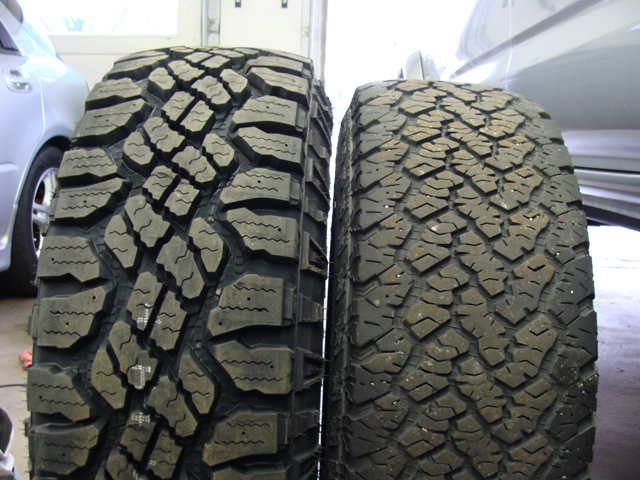

    Glad you were able to come to a decision bill-e-boy, I figured since it helped you out, I should share with the rest of the class...
    For anyone who finds this thread, facing the same dilemma....
    BEFORE: worn 265/70 R16 General Grabber AT2's on stock 16x7 wheels
    AFTER: fresh 265/75 R16 Goodyear Duratracs on 16x8 EagleAlloy100's 3.625 BS

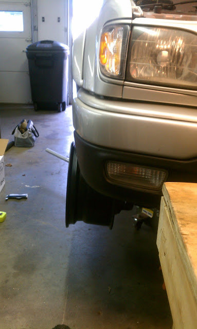

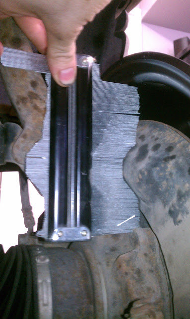

    oh, and the test fit before mounting the tires...

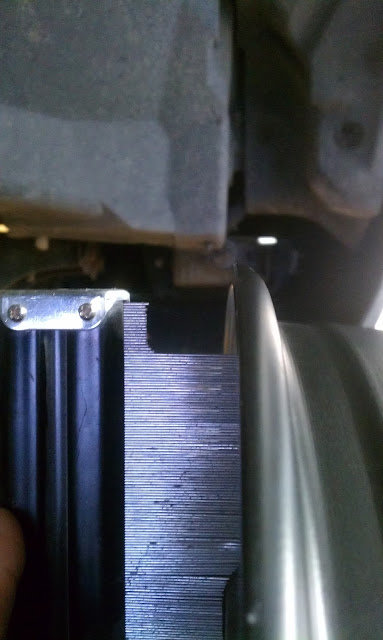

    ^ here you can see I'm measuring where the back of the wheel is positioned - I have already done the same measurement with the stock wheels in this photo (see the gap at the top)...
    ^ a closer look at the gap - 1" further out with the AE100's
    I would have put a measuring device in the photo, but I needed a third hand :D

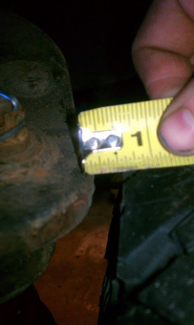

    Oh, and the clearance between stock wheel / tire size and UCA

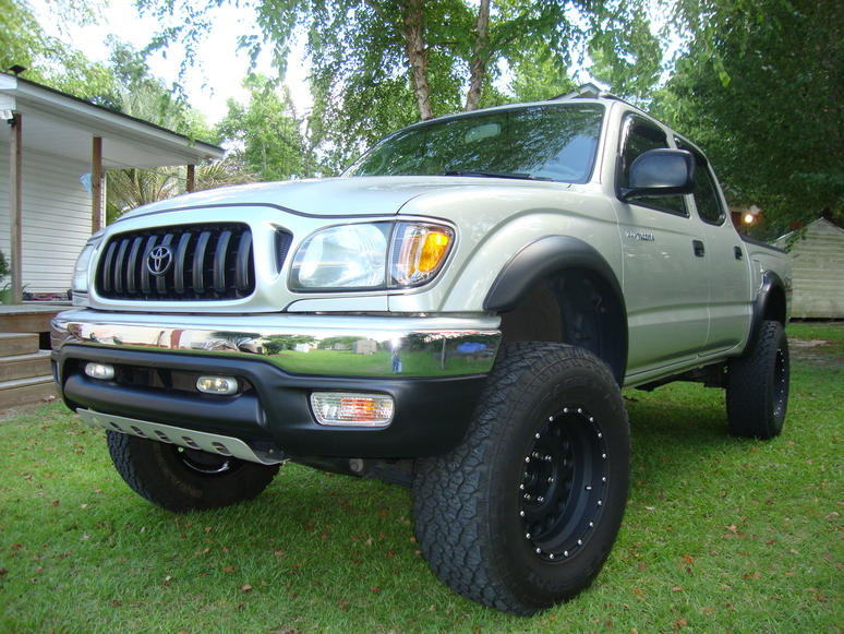

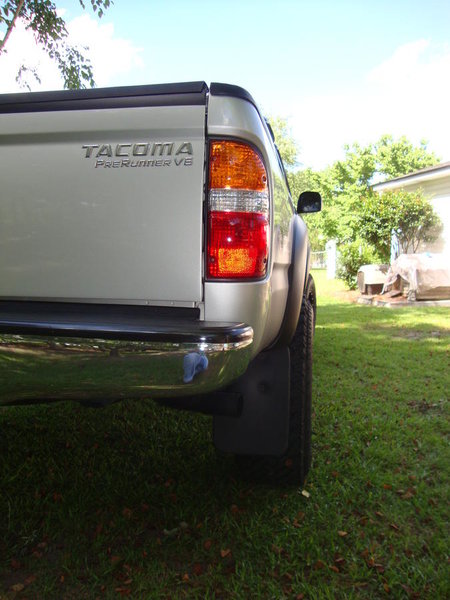

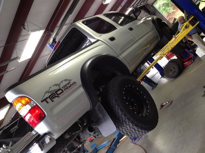

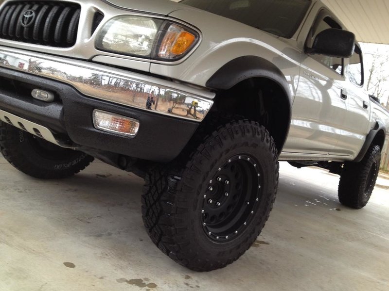

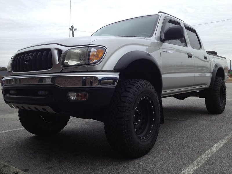

    rollin new wheels!!!!

    Nice looking set of slippers ya have there!

    Lookin' good! :bananadance:

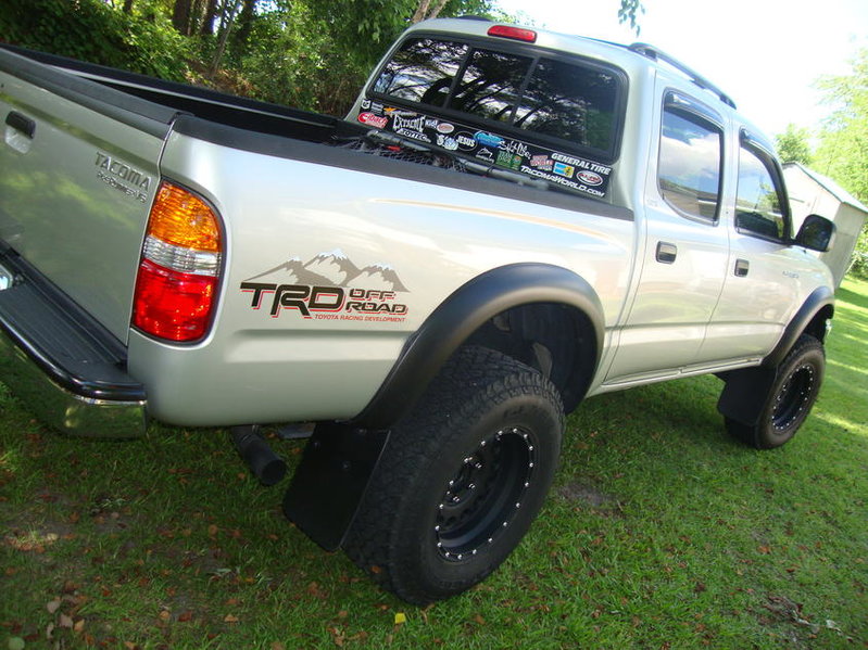

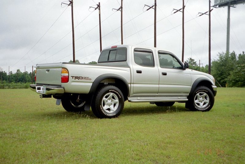

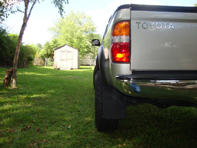

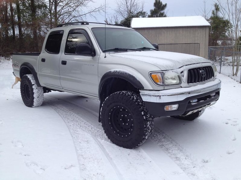

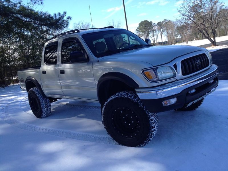

    the first shot is from when i bought the truck in 2004.....the others as is today

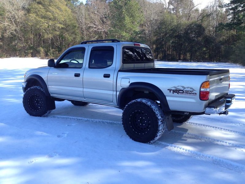

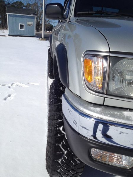

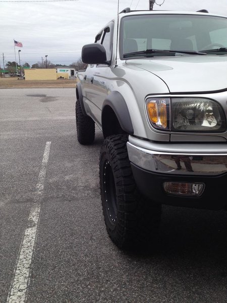

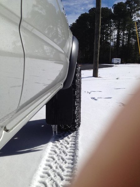

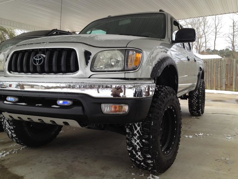

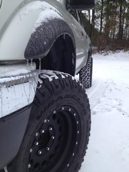

    ....side view showing the offset for those interested
