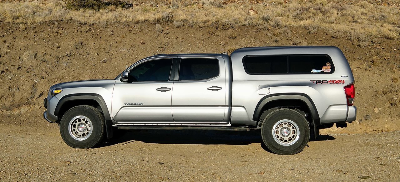

    '17 TRDOR DCLB FTMFWBBQ Silver Sky Met
    Bilstein 8112+650lb coils, 8100+Deaver Stage II leaf pack, SPC UCA, DuroBumps, Mobtown 0* sliders W/fill plates, Mobtown Recovery Bar, Radium PVC & CCV Dual Oil Separator Catch Can System, Snugtop Hiliner Sport, ATH bed Stiffeners (cuz bottle openers!) + front corner tie down, Badger plates for Firestone airbag + Relentless U-bolt flip + Daystar cradles, TRD Pro shift knob, TRD Exhaust, HPS Silicone intake tube, Green Filter, TRD Intake Air Accelerator, 265-70-17 Toyo Open Country ATIII on TRD 17" Rockwarrior Cold Forged wheels, TRD alloy front skid, RCI Aluminum transmission & transfer case skids. Much Meso awesomeness, FreshMexicanTaco TacoGarage Camera Controller + DDM, 67 Designs cradles, Banks Pedal Monster + iDash gauge, WarFab Sheridan hitch skid, Ricochet LCA aluminum skids, Rago lower rear shock guards, FN Koning Countersteer 16" spare, OEM T4R 90105-14104 coilover lower mounting eye bolts
    They should, I have seen many 1st and 2nd Gens rolling on the 3rd Gen OEM TRDOR wheels.
    I run 2nd Gen wheels on my 3rd gen with 265-75-16.
