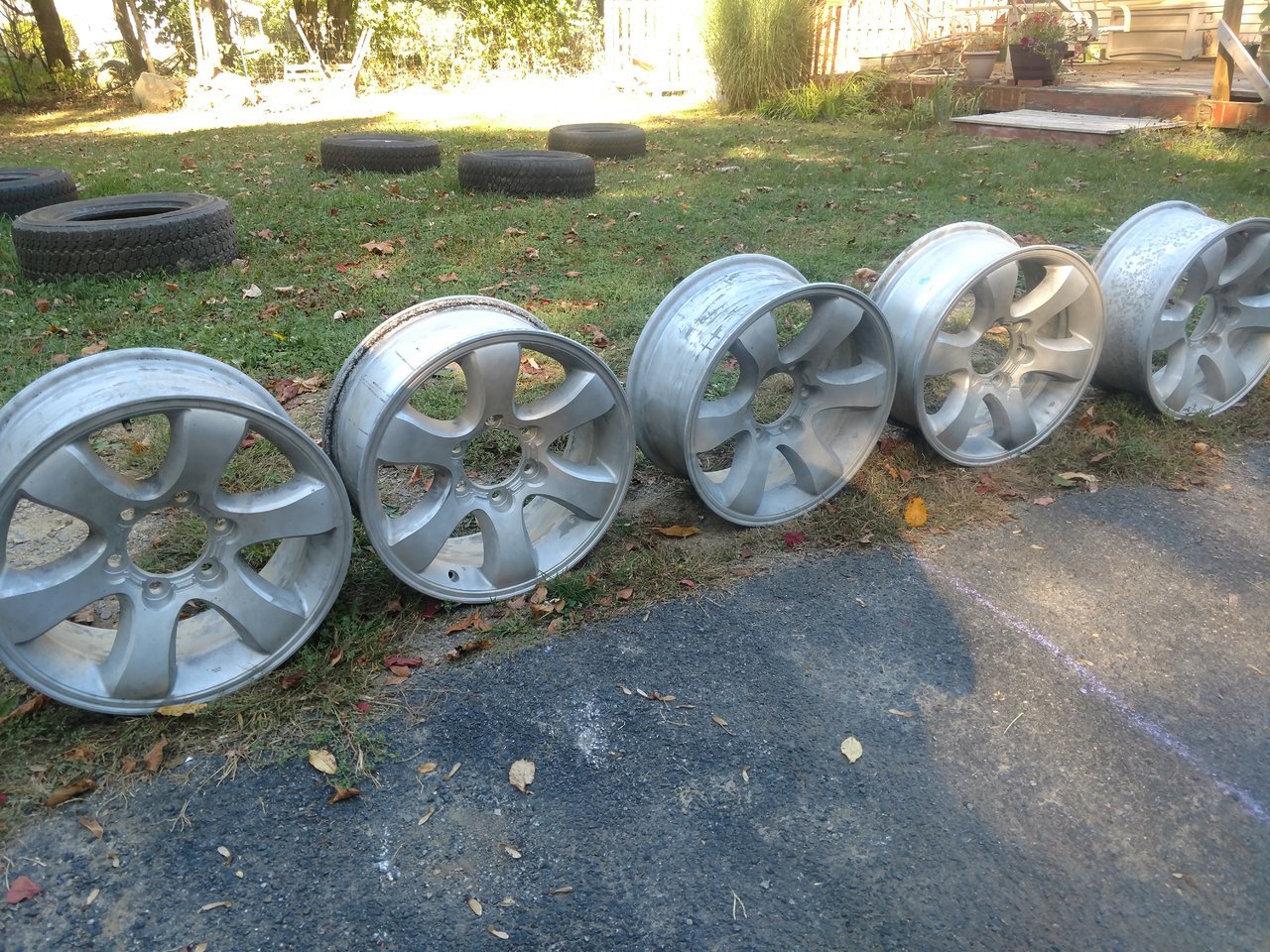

    Yes. Those wheels also came on Tacomas.
    The 4Runner sport wheel however will NOT fit. I mean it fits, but you would have to run spacers. Ask me how I know... :)

    I've had wheels rubbing my calipers for a year now :thumbsup:

    Shit....I have those being refinished for snows. Haven't test fit them yet.....

    I would test fit them anyway just to see if our trucks are different.
    They rubbed the calipers pretty bad when installed. I got some spacers, but then the front tires rubbed on the mudflaps lol.
    I only got two spacers to test out for the front, I'll ship them to you if you cover the cost of shipping. I think they are 1" from Amazon. I wound up grinding the outside of the caliper down with a dremel. Don't tell the TW police.

    I'll let you know. Might be a while until I get one back to test fit. Mine's a 2010 so no idea if the calipers are that different, but maybe. I won't have the problem on mud flaps since I replaced mine with ones that sit outside the wheel well. Also, I'm going to stock size vs. my 33's to keep my plow angle better.

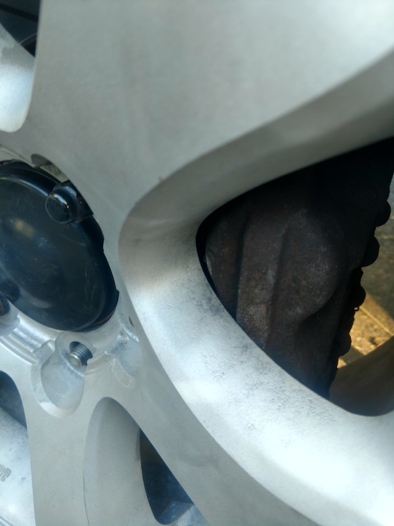

    Back from sandblasting....time to test fit then prime and paint.

    PM inbound..... they rub.....
