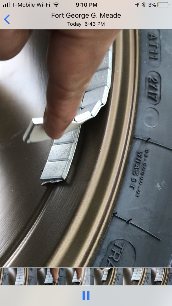

    **Also not sure if anyone answered it but the wheel weights should not be able to be lifted with a single finger and minimal (and I mean minimal) force, correct?

    as for your wheel weight question, NO! if they are stick on weights you shouldn't be able to lift them up with your finger unless you are going to peel them off for some reason. it should take some force. if they used knock on weights, you definitely shouldn't be able to pick those off the rim with your finger.
    good luck with your problems, I hope they take care of it and stand behind their work.

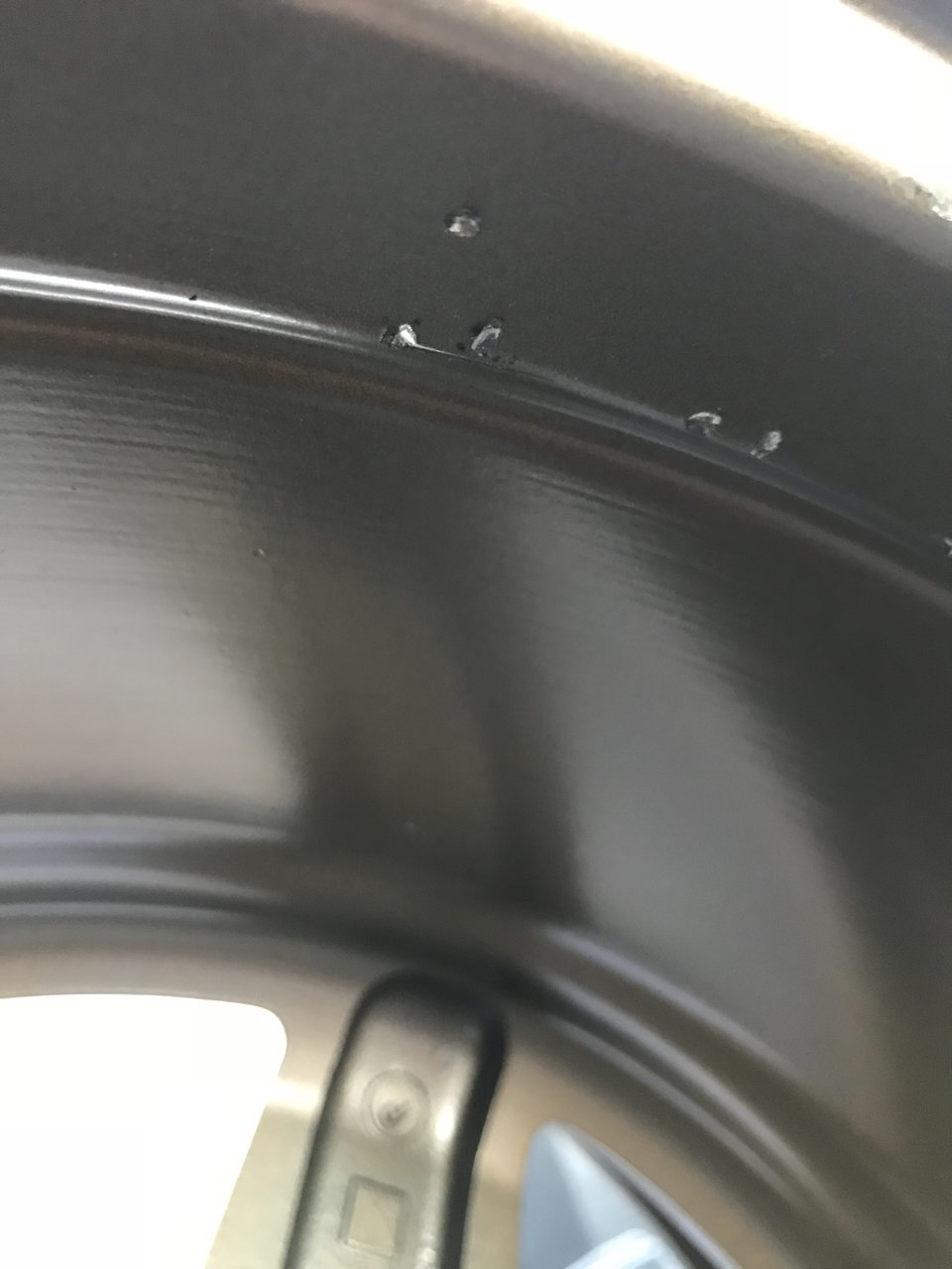

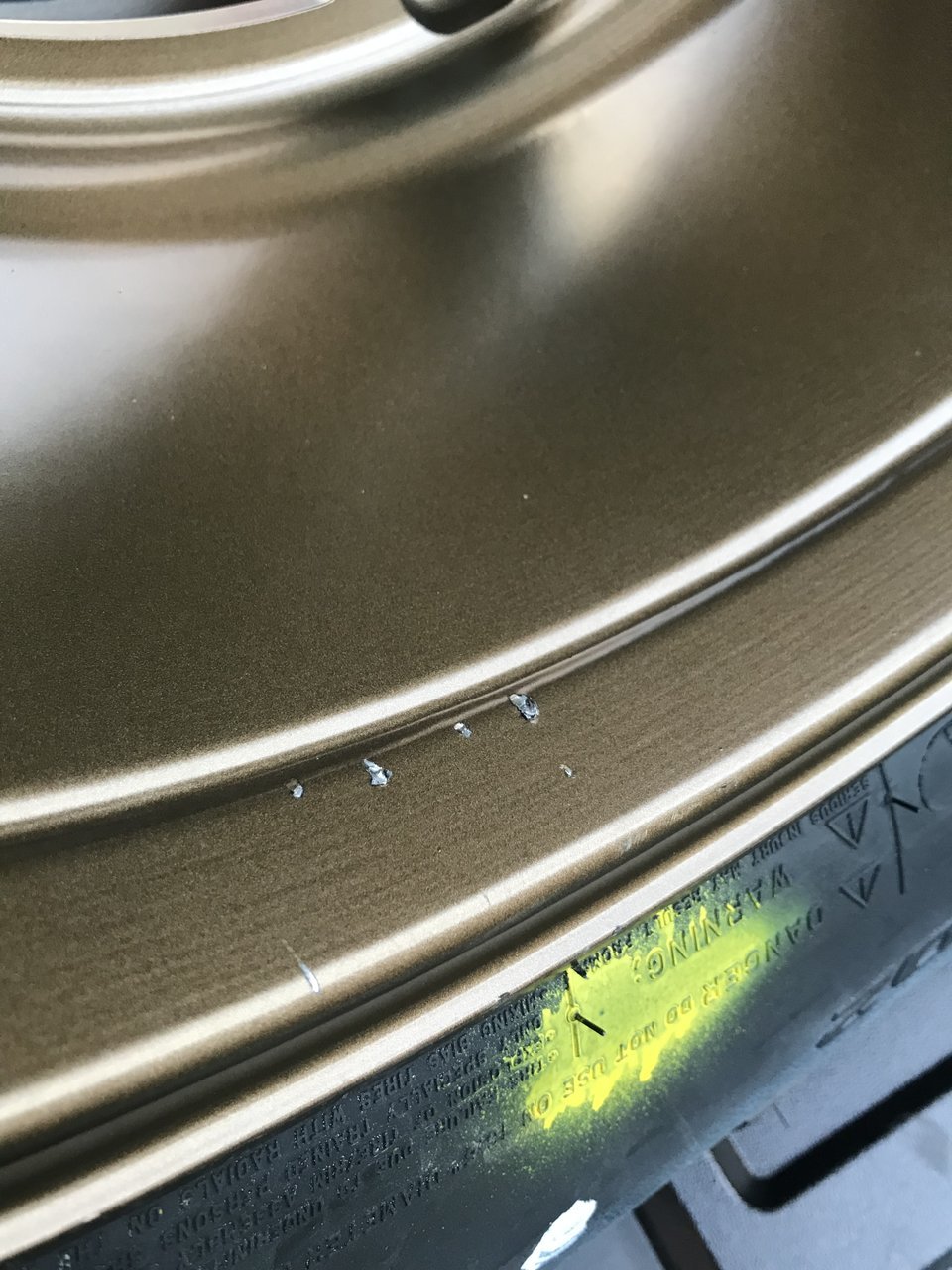

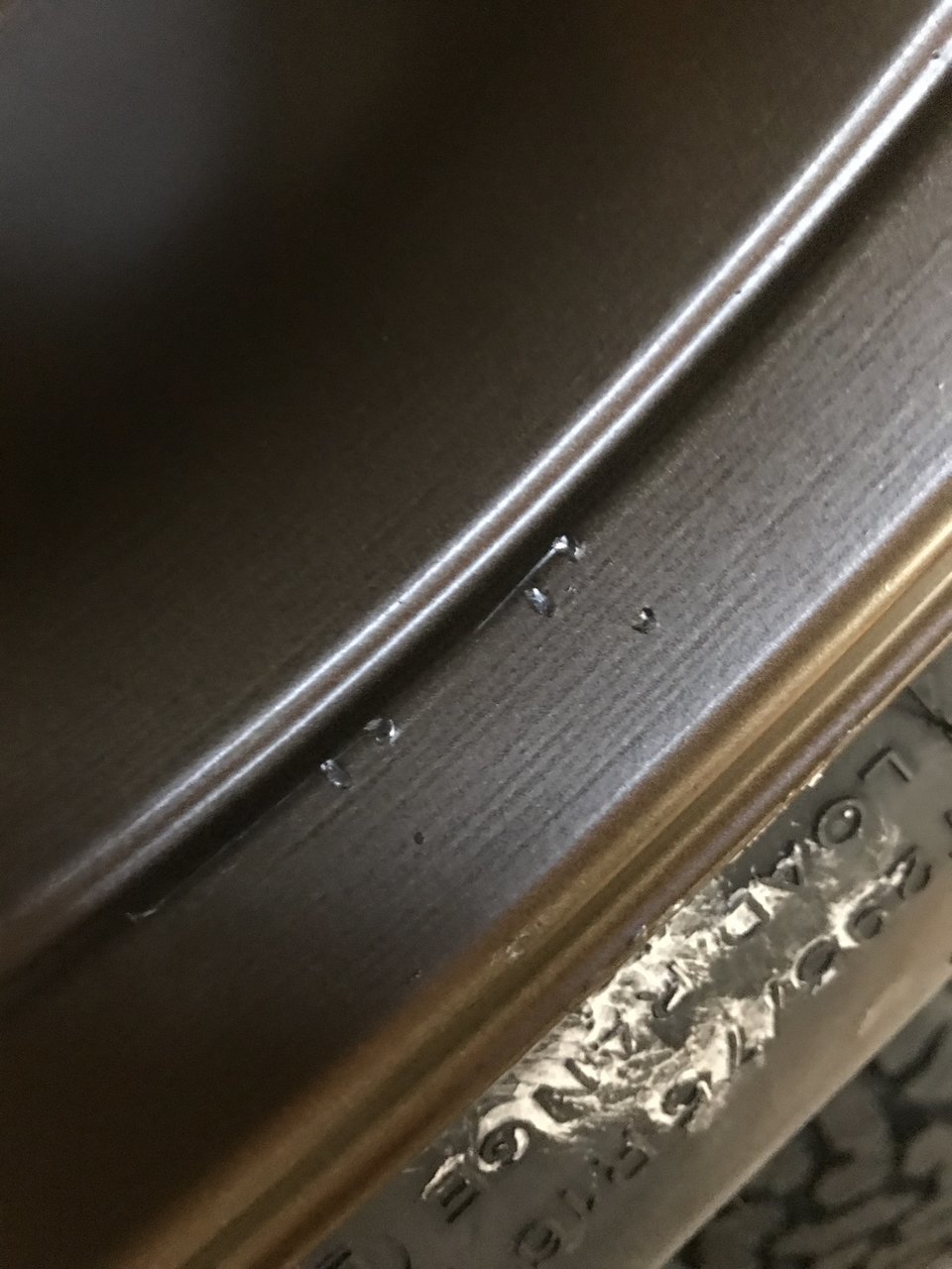

    Is the damage on the inner wheel normal? It looks like claw marks

    JimmySport is right, if you can flick off the weights with a finger, imagine what they would do spinning at highway speed!

    Their tools definitely did that.

    Technically at speed, they have inertia helping them to stay stuck.

    But you’re not always traveling “at speed” so if these come loose say in a parking lot, it could be pontentially dangerous.

    that is definitely not normal. and the damage on the inner rim is where their "claw" on the wheel machine comes in contact with the rim and clamps it down. is it normal? not really, but I have seen this type of thing happen before. most modern machines I believe are what they consider "touchless" mounting. I might be wrong on that but I definitely wouldn't call that damage normal.
    with all that said, I might even start to question the integrity of the materials used to make those wheels. it seems like the aluminum is really soft, just judging by the pics you have posted. I am not saying they are, and please don't take that as me saying your wheels are junk. I am just saying anybody who installs tires for a living should know what precautions to take to keep from damaging a set of wheels in today's world.
