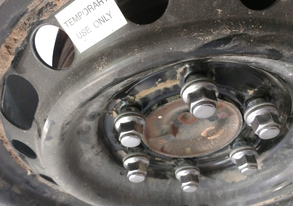

    Si nce this is a lug nut thread, or closest to it, I woke up this morning to a flat on my 24k Gen3 . KEVLAR tires bullet proof right?
    So, I took the opportunity to do a stock wheel exchange to the stock spare. Has anyone else done this? Been a long time since I actually HAD to change a tire.
    My biggest concern is that the stock lug nuts do not fit down into the wheel holes. So the back part of the lug does not fit down through the wheel's lug holes.
    Is this normal? I'll definitely run it around the yard and re-torque, but I think that's iffy. Sorry , no pictures, phone dead too :(
  17. Aug 4, 2019 at 9:53 AM
    #77
    EatSleepTacos
    Mar 24, 2015
    #151688
    59,841
    Randy
    West Valley, AZ
    2017 4Runner
    Stock lug nuts are designed to work with the spare. You’ll be ok. I know what you’re talking about and that it looks odd, but it’s designed to work.

  19. Aug 4, 2019 at 10:59 AM
    #79
    GilaTrails
    GilaTrails Well-Known Member
    Oct 4, 2018
    #268355
    254
    Champaign IL / Safford AZ
    2018 Inferno Tacoma TRD Offroad
    Matching Colored Tire Valve Caps
    Thanks for the vote of confidence , here's a snap of what I was trying to describe.
    And the culprit pretty close to side wall :cry:
