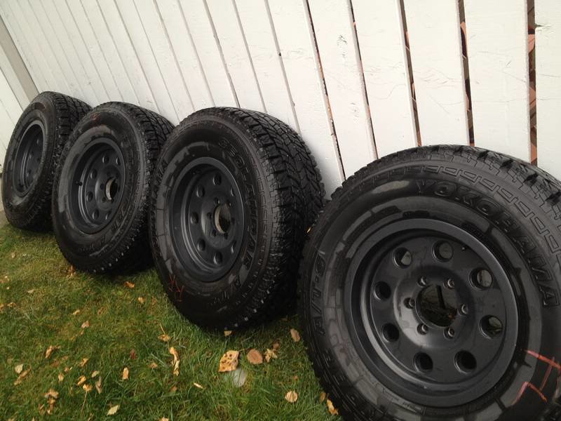

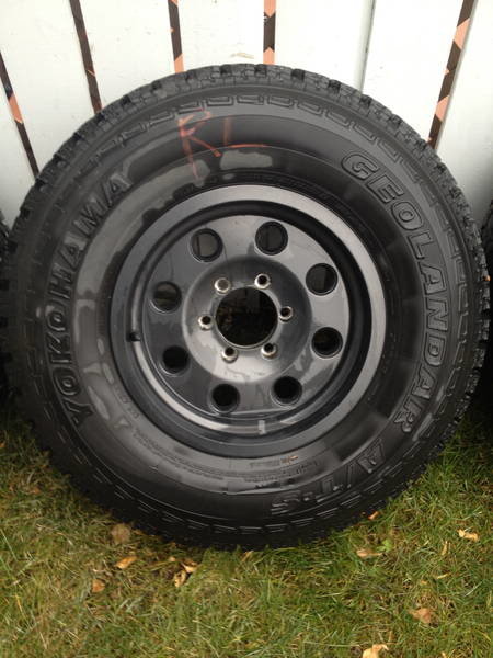

    I just purchased the American Racing Mojave Teflon 16x8 rims with Yokohama Geolander AT/S 265/75/16 tires of of local classifieds yesterday.
    1) Just wanted to confirm they will actually fit my TRD Sport. I thought I remember seeing a few guys running them here on TW so I bought them. I understand they will be sticking out more than stock which is fine.
    2) Anyone has experience with these particular tires in 265/75/16 without lift? According to sticky thread they should be the largest size I can run without rubbing. Maybe I will have to loose mud flaps?
    3) I purchased rims, tires and lug nuts, but not center caps or TPMS. Should I look for center caps for these? I know many people do not use center caps because of looks. Should I be using caps or it does not matter whatsoever. I will run these only in summer as I have a dedicated winter set now.
    4) How do these tires compare to other popular All Terrains such as Duratracs or BFG AT KO's?
    5) Also which type of tire pressure sensors will fit these wheels? I understand not the stock ones?

    The mojaves will clear the calipers fine. Your toms will work on these if you have stock alloys. If you have steel wheels, the sup can use tpms straps to get them to fit as well.
