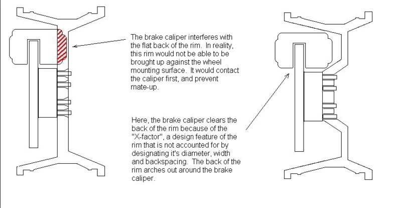

    Correct. "the x factor"
    pjensen641 and c4lvinnn[QUOTED] like this.

    ^ This...it was illustrated on the thread linked a few posts back. I've seen wheels from +30 to -20 offset that fit. Some spoke designs, even with offset in that range, apparently don't clear calipers.

    Thats when they need to adjust the offset specs via backpad thickness and not by lip size specifically. If you have a thick enough backpad, your spokes will naturally angle away from the mounting point/hub/backpad giving you room to clear calipers.

    There are a lot more variables to wheels most people don't realize. It isn't always as easy as diameter, width, bolt pattern, offset and hub bore.

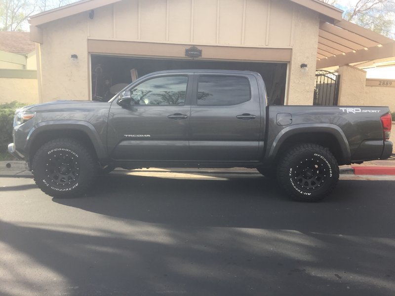

    If you can find a shop that would try the 16 pro comp on to see then do it. I had every shop I called tell me that no 16" from any maker can ft on my sport. They were completely full of it. Here's my sport with my simple 16x8.5 0 offset MB's with my new 265/75's I got last night.
    So find you a shop that will try
