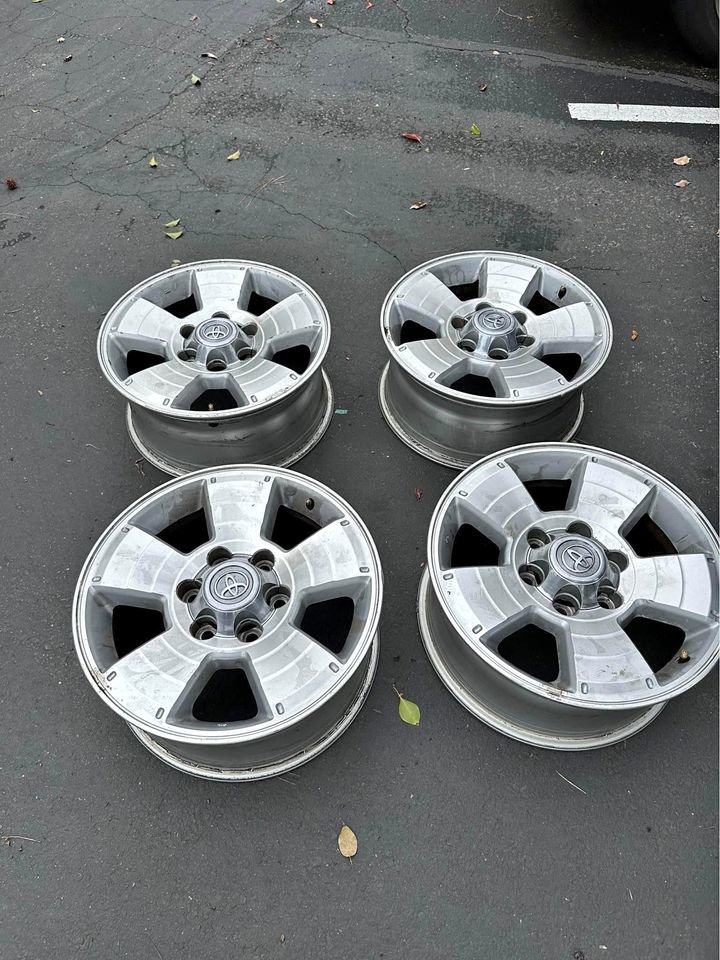

    Been awhile since I have posted. I'm looking to buy some Forerunner wheels for my Tacoma.
    Question:
    Can anyone tell me if 2003 Forerunner 17" wheels will fit my 03 Tacoma prerunner 2wd? Both are 2wd, lug pattern the same, 6-lug. The seller tells me the wheels are not TRD pro model so that is a good thing.

    Do you happen to have a photo of said 2003 4Runner 17" wheels? Might help someone chime in who has them on their Tacoma. Picture worth a 1000 words and all that...

    I currently am running stock rims on my 03 TRD 2wd.
    Here is the fb post

    No issues with rubbing, or are you on small tires? One site says that an '03 4runner 17 inch wheel is 7.5" wide, 30 offset. That makes it almost 5.5" back spacing which is a almost a full inch more than the OE Tacoma wheel.

    From the thread linked above by @time623 (posts 54 & 56), which look just like the wheels you're considering:

    More backspacing puts the wheel/tire inward towards the frame. That can cause frame rub. So a wheel with more BS than stock isn't necessarily good, but also might not be bad depending on tire size.

    According to ads for that wheel, it's an aluminum 7.5" wide wheel, with 30mm offset, which equates to somewhere around 5.75" of backspace.

    Is that 5.75 backspace gonna cause a tite rub??

    At 5.75" BS I have a feeling you would've ended up needing spacers anyway.
