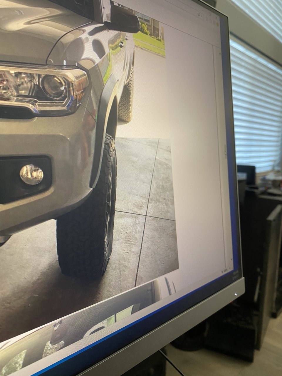

    Like that looks good to me and those are stock I assume

    That looks like a -10 offset with a 265 width tire, its poking out around 3/4 inch. if you went with a wheel like a SCS 8.5 wide with -10 then you would want a 255 80 17 to keep it even with the fender flare.

    the -10 with a 265 is outside the fender for sure, if you go with a 255 85 16 or 255 80 17 to get a 33inch you will be pretty even. If you can go with a 0 offset and a 265 should be even with the fender.

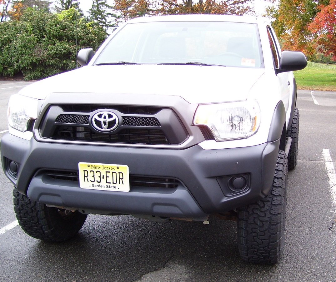

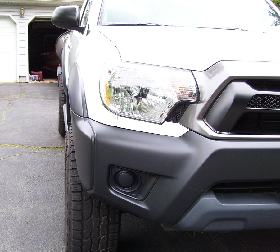

    Here's a picture of my truck with a 285/75/16 tires on 16x8 wheels with 0 offset 4.5" backspacing. The tires bulge out some but if you went with a 265 or narrower, it would be even less with the 8" wide wheel.
    And for comparison, here is the truck with 305/65/17 tires on 17x8.5 wheels with -10 offset which is closer to 4.25" backspacing. Both tires are around 32.8" height so basically 33's.

    Thank you for posting that! Yeah, looks like the tread is right on the edge with the bulge of the tire sticking out.
