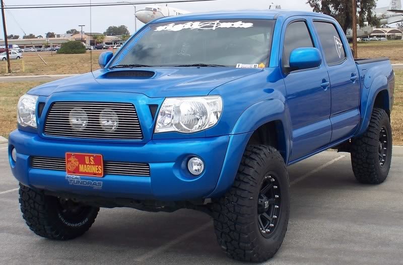

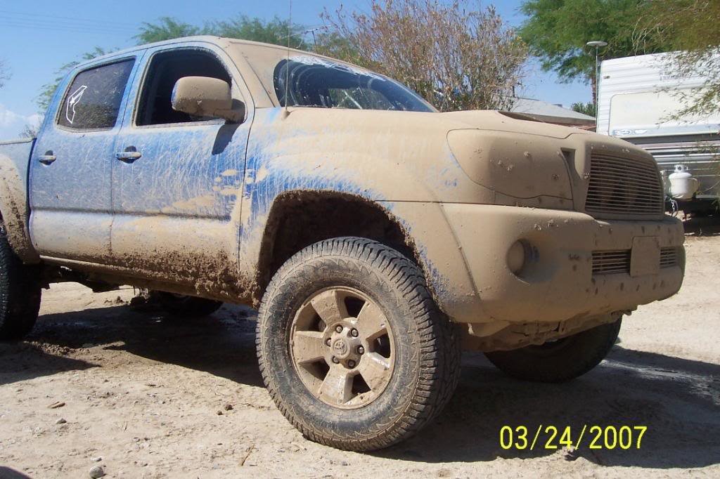

    I ran 285/70/17 Hercules TerraTrac A/T on my Stock Sport rims for almost 2 years. And I went offroading pretty often. They did rub on the stock UCAs at crank but for normal driving they were fine. You are running TC UCAs which are smaller around the uniball. so more space there. You should try it. If it doesnt work you can keep the tires and just get new wheels and then you will be set. Good luck.
    Before: Stock Wheels and 33s
    After: 17x9wheels 4.5" backspacing -12 offset w/ BFG KM2s 285/70/17
