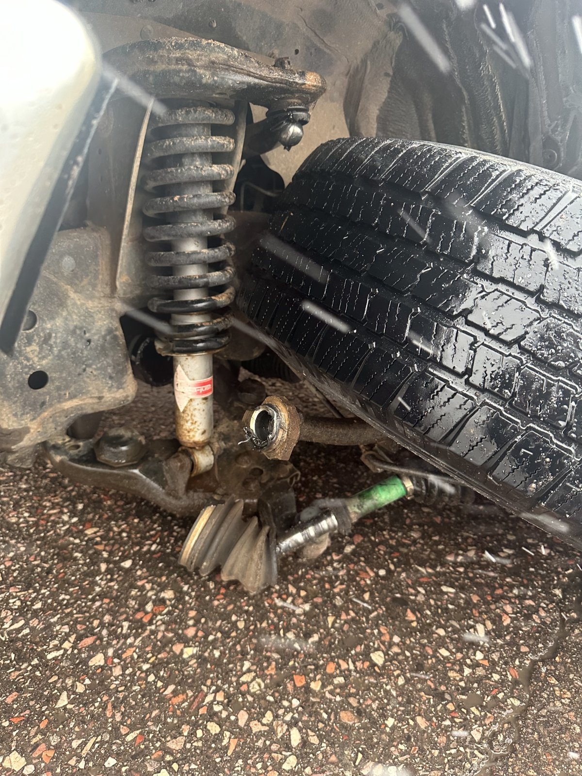

    Hit a few potholes recently and last night the ball joints decided to give out on a stretch of smooth road after 28 years. Right next to the casino
    Anyone else with a similar experience? Today I will get the truck jacked up and tire removed and evaluate the damage.

    They have been bad for awhile.

    There is a reason it was redesigned after the first gen, you just found out why. On the first gen, when it's loose/old, it WANTS to come apart due to the design.

    These situations are a shame, because a few-hundred dollars in ball joints replacements could've saved a couple thousand in collateral damage to the truck

    That sucks, dont worry OP we will add your truck to the collage. There has got to be hundreds of posts like this where the ball joint becomes no more and the wheel falls off.

    Yeah very common failure unfortunately. Thankfully it is avoidable, but you have to know about it to avoid it. Seems like a lot of people only learn about it after the fact unfortunately.
    Here’s mine: https://www.tacomaworld.com/threads/lbj-failure.506985/
    Thankfully I was going very slow, looks like you weren’t quite as lucky. Hope you’re alright
    Just got to keep track of it and replace with new (OEM ONLY) joints every 75-100k and it won’t happen again.
    Heres a couple good informational links for the LBJ and LBJ bolts
    https://adventuretaco.com/guide/ste...s-lbj-on-a-1st-gen-tacoma-or-3rd-gen-4runner/
    https://adventuretaco.com/guide/choosing-lower-ball-joint-lbj-bolts/#google_vignette
    TLDR:
    04005-03235 is part number for LBJ kit, comes with both left and right but no bolts. Saves quite a bit of money vs buying the left/right separately. If one failed, just replace the other now.
    90119-10933 part number for the 'best'bolts, though hard to come by in stock.
    The bolts are also a common failure point, don’t reuse the old ones.

    The root cause of this is a lack of proper maintenance. What else has been neglected?

    For all expressing their concerns for my wellbeing, I appreciate it very much. My lady and I got lucky. We were about to head down a 26 mile long twisty windy dirt mountain road and had just finished filling up the gas tank. Pulled out of the station going about 25 mph down the road and it just gave out. I was able to veer over to the curb, threw the hazards on and waited for a tow at the casino bar. New ball joints otw

    So I got her all put back together again.
    This is a 1995 truck.
    I used:
    LBJ #43340-39436 w/ black bolts #90119-10933
    UBJ #43310-39016
    NAPA CV axle #941733
    NAPA OTRE #PCC ES3546
    Also changed the rubber brake line.
    I got shafted by NAPA because it appears they sold me the extended travel CV for $170 more and not a direct replacement. My bad for not checking. Seems as if it will be much harder to remove in the future as there are no spots to pry on.
