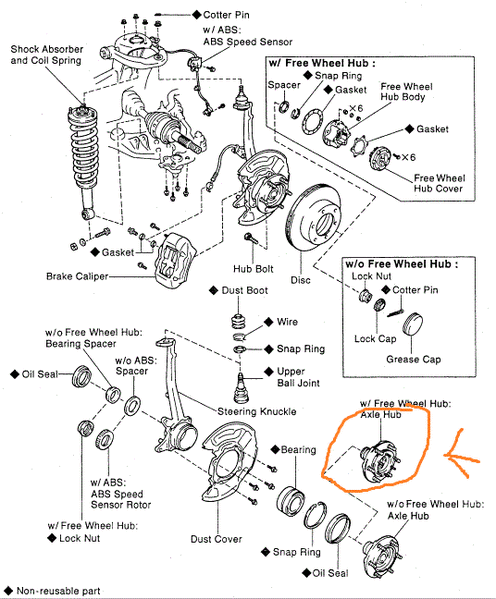

    I need to get a front wheel hub for a 96 Tacoma 4x4 with manual hubs. The only ones I can find don't have threads on the end and I need the one that's threaded with the nut on the backside. Do y'all know where I could get one

    If you're talking about this thing:
    We were just having a conversation about this same thing like 2 days ago....
    https://www.tacomaworld.com/threads...r-knuckle-assembly-manual-hub-non-abs.490825/
    The manual hub seems to only be available new from Toyota (there are eBay sellers selling them, but they seem to be Toyota dealers still). No after market has been found so far. So options are a used one from a wrecker, or a new one from Toyota. Part number is 43502-04030 or updated part 43502-35160.
