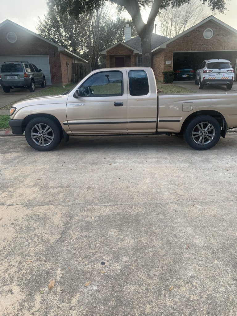

    i have Hyundai Sonata rims....perfect fit....225/65/r16 for our 5lugs

    Hope helps:
