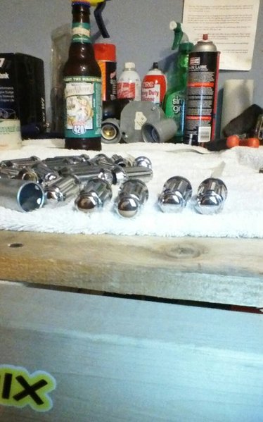

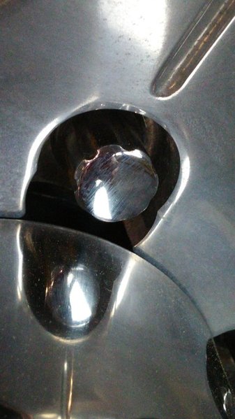

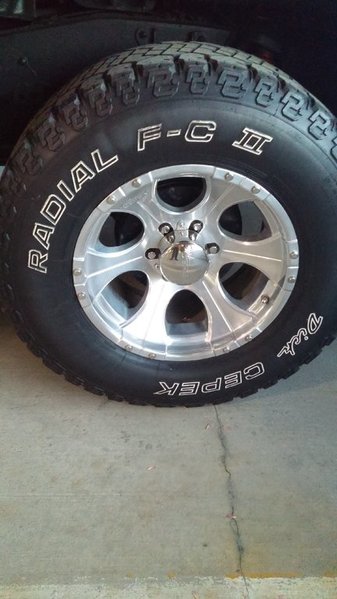

    This is what I'm dealing with, got pics of the locks themselves and a wheel. As you can see, I have 6 on each wheel...0511152011d.jpg 0511152011c.jpg

    those locks look like the standard ones that like autozone sell and Discount/Americas tire sell they should have one that will fit that
    or you buy cheap sockets that are big enough to fit over them but small enough to be somewhat tight where you have to hammer them on then take them off that way

    I had the same looking lug nuts. Went to pep boys they have a couple different sizes, ask to see if it fits. I paid 8$, not a big day al.

    Those are just conventional spline-drive lugnuts, popular for aftermarket wheels because the socket can be smaller, less chance of scuffing up the lug hole.

    What you have are referred to as splined lug nuts,,, most after market rims don't provide a large enough hole for regular lug nuts, that's why they use these.
    Don't go trashing your nuts, just get the right socket for them, better yet get 2 cause the side wall on the sockets is very thin, they like to split at the most inopertune of times.
    P.S. I have those same nuts on my truck and they work just fine.
