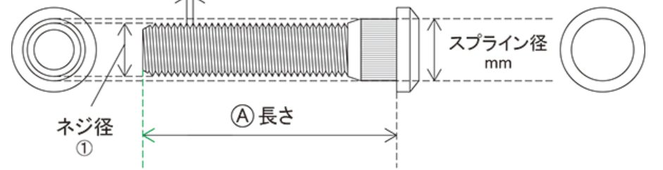

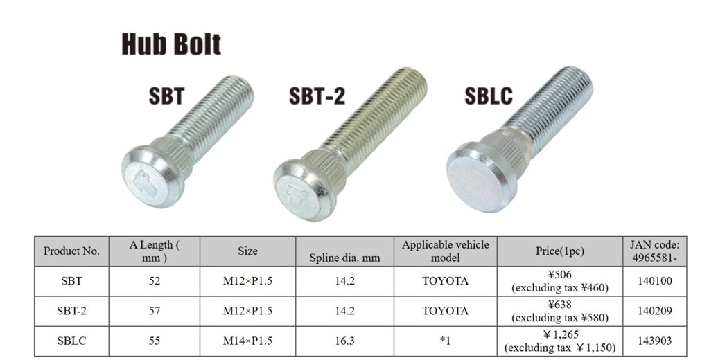

    The KYO-EI studs are the only ones I know of that make an extended stud.
    They were actually made to be used with their 10mm wheel spacers.
    They are 55mm long. Note: that measurement includes the splines too. Not just the threaded portion.
    I do not know the actual length of the 4th Gen Tacoma Studs. If you really want to be sure, measure yours.
    My research says, the SBLC lugs are 10mm longer.
    The only US supplier I can find wants $145.00 for 10 studs. https://www.topendmotorsports.com/l...-9lfHrv0ziqFuyV1lJb566Mj7aT-SgxJ4cZ4V4XRn77yr
    Ordering from Japan is $7.00 each. - https://www.blackhawkjapan.com/prod...UTyJxAF2bYuvdpLfiUqFU9LdgZ9Fi2WtMeOGqyB52nIZ8
