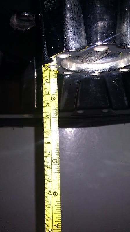

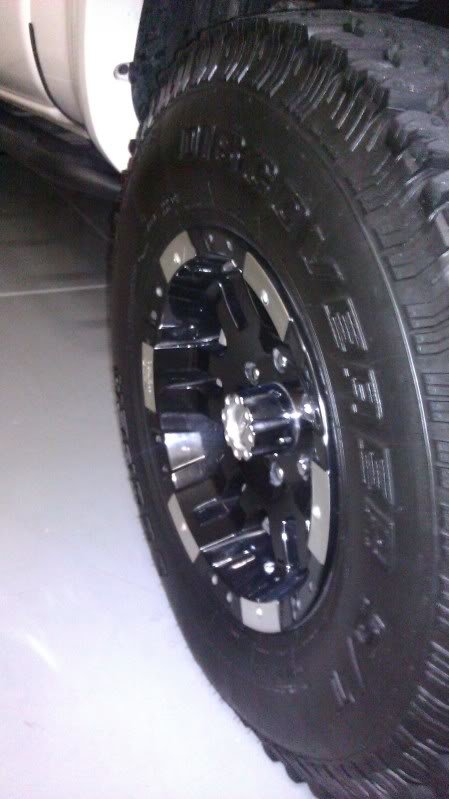

    So I measured my wheels today out of curiousity and discovered some weird results. I ended up with almost 6" backspacing and a wheel width of about 9" but the backspacing is supposed to be 4.5" and the width is supposed to be 8". They are ATX Chambers. One reason wanted to measure them is because they don't seem to stick out as far as some other wheels I've seen with 4.5" backspacing. And American Racing doesn't advertising making these wheels with anything more than 4.5" bs. Do manufacturers not use actual numbers or something and just make up numbers that are popular? Has anyone else had this problem? btw I didn't take the wheel off to measure so my measurements may not have been exact, but they are definitely not as advertised. I also looked at this thread if you're thinking I may not know what I'm talking about:
    http://www.tacomaworld.com/forum/wheels-tires/102992-wheel-backspacing-offset-info.html
    I don't have any real good photos of the wheel, but here's one to give you an idea if it helps.
    Do you think these wheels are more than 4.5" bs? Thanks.

    Ya those look more like how the stock wheels look more than how mine with 4.5" BS look.
    I can take a picture with that same angel for comparison purpose if you would like to use underneath your picture..

    ya that would be cool if you wouldnt mind. And maybe a quick measurement why ur at it :)

    Since you didn't take the wheel off, did you measure backspacing as the back edge fo the rim to the rim seat? or did you measure it to one of the spokes?

    I measured it from the inside edge of the wheel to the innermost point of the spoke nearest to the lug nuts

    Hmm sounds like you did it right....

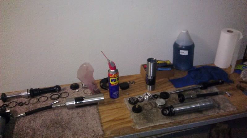

    Sorry I was in the garage rebuilding some Fox shocks and forgot about this thread lol let me get the pic up here in a minute

    3.5+4.5 (BS)= 8" rim lol
    the work I got distracted with...
