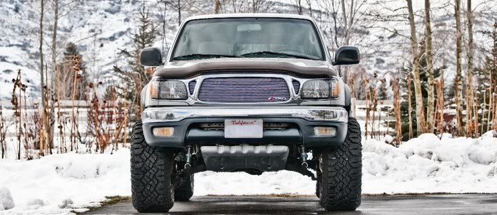

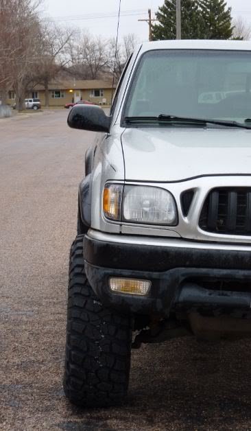

    For reference, this is how far 33x12.50s with 4" backspacing on a 3" OME lift will stick out. You won't need a body lift to fit 33s especially if you don't wheel a lot, some modification to the pinch weld will suffice.

    is it the less backspacing, the more they will stick out?
  12. Dec 14, 2011 at 11:10 PM
    45acp
    45acp Paint me back in Wyoming again...
    Aug 9, 2009
    #20861
    6,606
    Jonathan
    Fort Collins, Colorado
    bone stock / unmolested 04 2.7L
    Yeah, 3.75" BS will stick out 1/4" further.

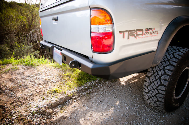

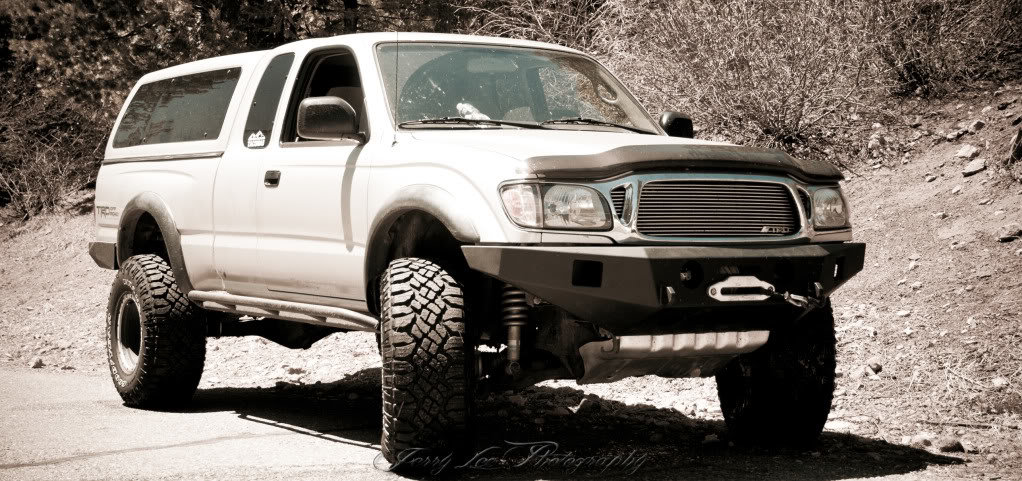

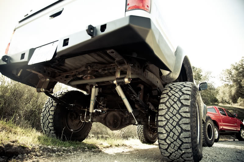

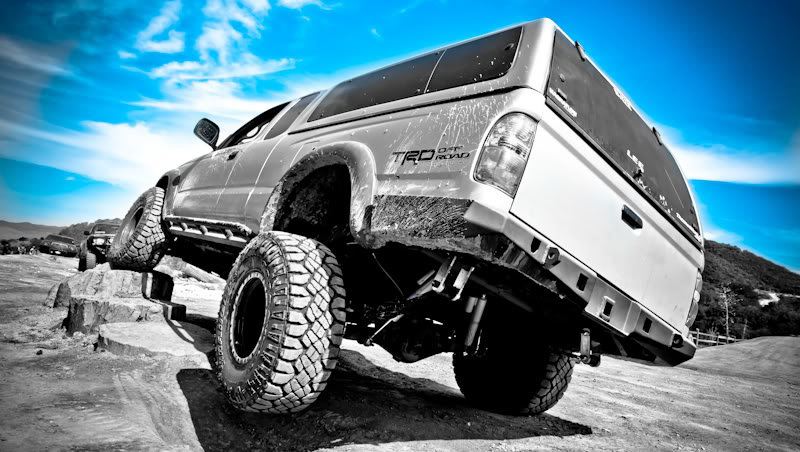

    33x12.5x15's on a 15x10 with a 3.75" BS and a -44mm offset. I hope that gives you a good idea how it will sit :cool:
