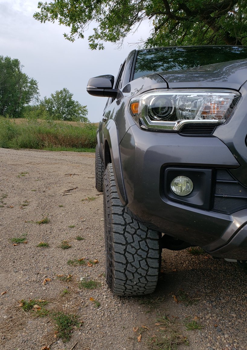

    Chances are (depending on wheel width) 0 offset will line your sidewalk up with the fender.
    -6mm the tread path will likely line up with fender and sidewall will poke out maybe 1/4".
    265/75/16 on stock wheels +25mm
    Used 1.25" Spidertrax wheel spacers to give -7mm(-6.75)
    pics in profile

    I wasn't sure what to expect on my truck so I went with spacers to see how much poke I would get vs. buying expensive wheels that I was unhappy with.
    Now I know what -7 will be and if I choose to get new wheels. Now I'll know what offset I want. (I like -7)
    Good stance. Better cornering. Doesn't kick rocks all up the side of your truck.

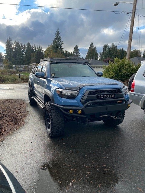

    17x9 wheels 0 offset 285/70/17 KM3"s offset.jpg

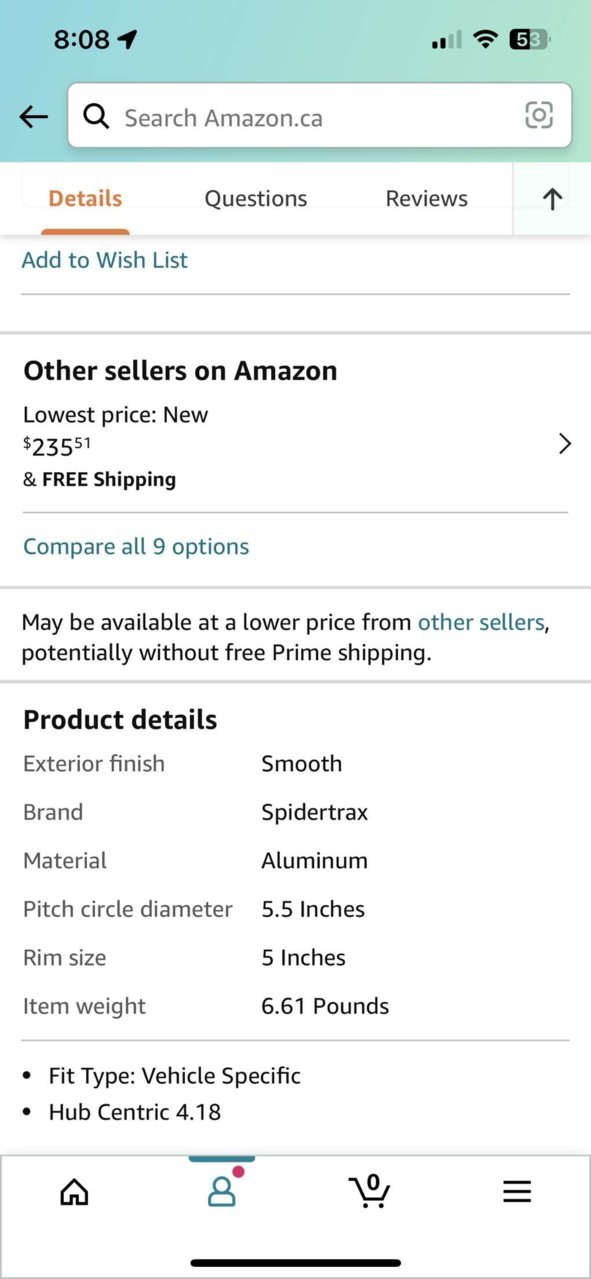

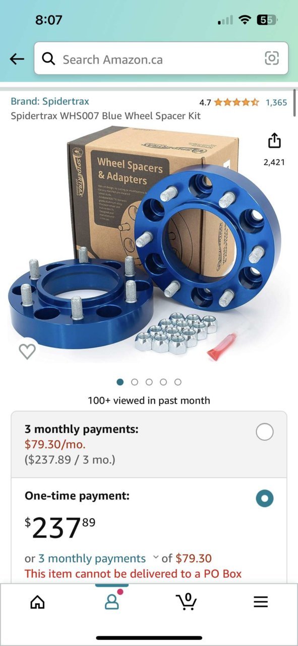

    Recently picked up a set of 4th gen Runner limited OEM wheels >17" 7.5 ET30 going to be installing 265/65R17 Nokian hakkapeliitta 10s on my 2019 Tacoma sport stock suspension. All my research has suggested that they are the exact same specs as the stock wheels for my 19 sport... however i did purchase 1.25 Spidertrax spacers for all 4 corners of the truck to get the "poke" that i want the combo all said and done should give me a -5mm offset . This set up also changes my back spacing from 138mm to 103mm , I am worried about rubbing . I located my 1.25" Spidertrax from Amazon are they legit ? Snapchat-2118794809.jpg Snapchat-1685136372.jpg

    Isaac
    2019 taco
