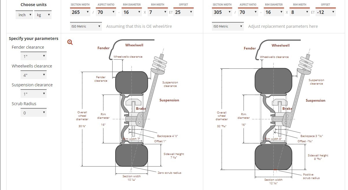

    So I pulled the trigger on some SCS R8’s (16x8 -12mm offset) on the revtek website (3” lift) they claim you can fit a 33x12.5 tire on with “minor trimming” I’m think more along the lines of CMC and a fair amount fender trimming. I’d like to run a 305/70 r16 Falken M/T. My question is How far past the fender flares will these stick out and will this tire/rim combo cause any other issues that a CMC and “minor fender trimming” can’t cure? Thanks!

    They will stick out 2-1/4" further than the stock tire.
    It will increase positive scrub radius by 1-1/8"; no cure for that.
    It is equivalent to adding a 1-1/8" wheel spacer, as far as scrub radius is concerned.

    I think you misunderstood...
    The tire will stick out 2-1/4" further than stock.
    Scrub radius is moved 1-1/8" to the positive.
    In the stock setup, your tire rotates around SAI at very near the tire centerline.
    In your new setup, your tire rotates around SAI 1-1/8" further from the tire centerline.
    305s add about 2" more tire outside of SAI.
    285s add about 1.5" more tire outside of SAI.
    I only mentioned scrub radius, because you asked about other issues rather than clearance.
    Seems you are already committed to trimming and chopping.
