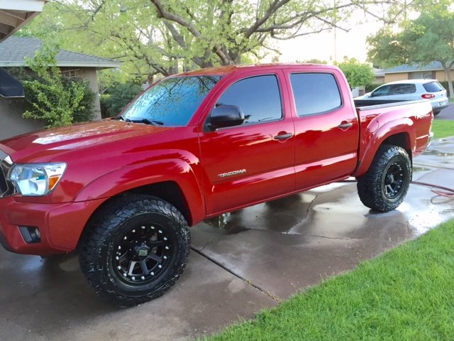

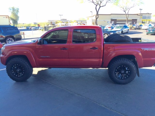

    I finally pulled the trigger and got wheels and tires. I went with the 275/70/17 KO's and the 17x9 XD Addicts -12mm. It was a little tight getting the 275's on there but it worked. Did a little trimming and removed the front flaps, need to do a touch more, but not much. I love the way it turned out. No lift yet, but down the road I may do the 5100's.

    Looks great! How are you liking the KO2s? Have you noticed a big power loss and mpg hit w/ the 275s? especially since they're load range e?

    The KO2's have been great! They are a perfect balance of an aggressive look and daily driver tire that I was going for. Hardly any change in noise compared to the stock BF's that were on there originally. I can tell it is a little bigger tire in the sense it is more stable and has better grip. I don't feel like there is much loss in power at all, maybe just slightly. The MPG's is tough to gauge because it is a wider diameter tire so the amount of miles I drive on a tank has gone down, but in actuality it would be higher than what it is showing.
    I referred to this to see how much of an effect it had. https://www.tacomaworld.com/tirecalc?tires=265-70r16-275-70r17
    The only thing I've had to mess around with is a little bit of rubbing. It's only when I back up and turn the wheel a certain way. I just need to adjust some of the plastic in the wheel well and that will be fixed.
