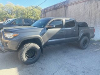

    2 1 lift w custom wheels and tires
    Just put 265 75 16 Falken Wildpeak AT3 on 16 in KMcs with a 2 1 lift with no rubbing and no removal of mud flaps
