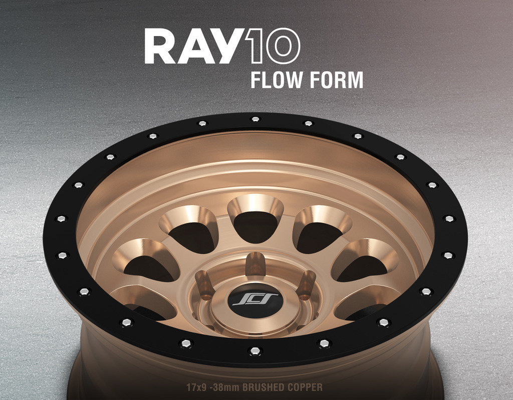

    -38

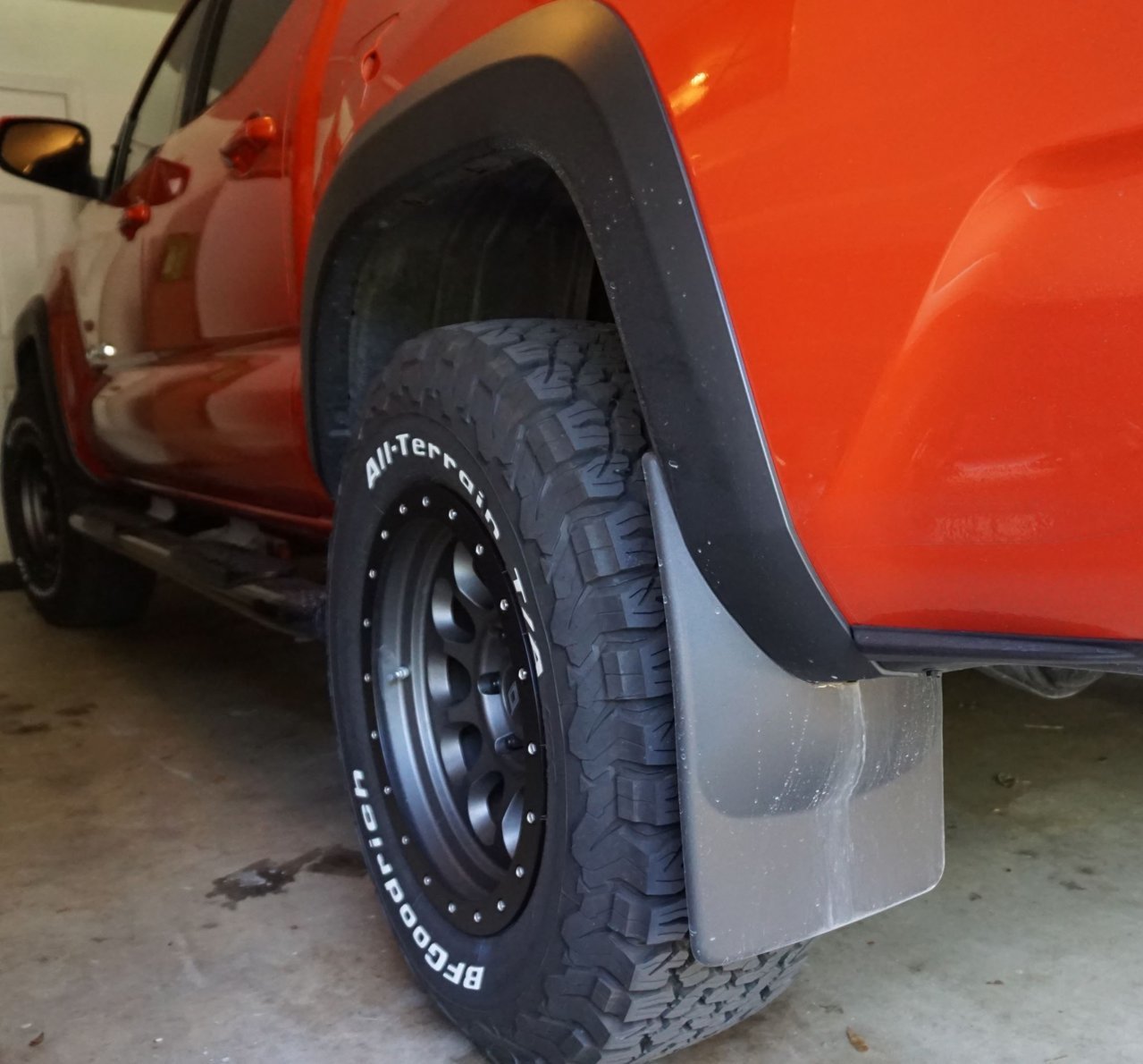

    What size tire are you running?
    The Toyota TRD Beadlock like wheels are a 7.5" with a 10mm offset and they stick out about 1" with a 265/70. Depending on tire you will likely want to be similar with around 0 offset.

    Lol. Well, I’ve seen some advertised as of late, but I would not put them on my truck.

    Ya those would stick out far.

    The 17” Ray 10’s I had with 265/70/17 KO2’s were a little outside the fender flares. Those wheels are -10mm offset.

    Depends, I have positive offset on my stock wheels and they stick out about 1". My 8" wheels only have -12 but running a 12.5 tire they stick out almost 3 inches.
