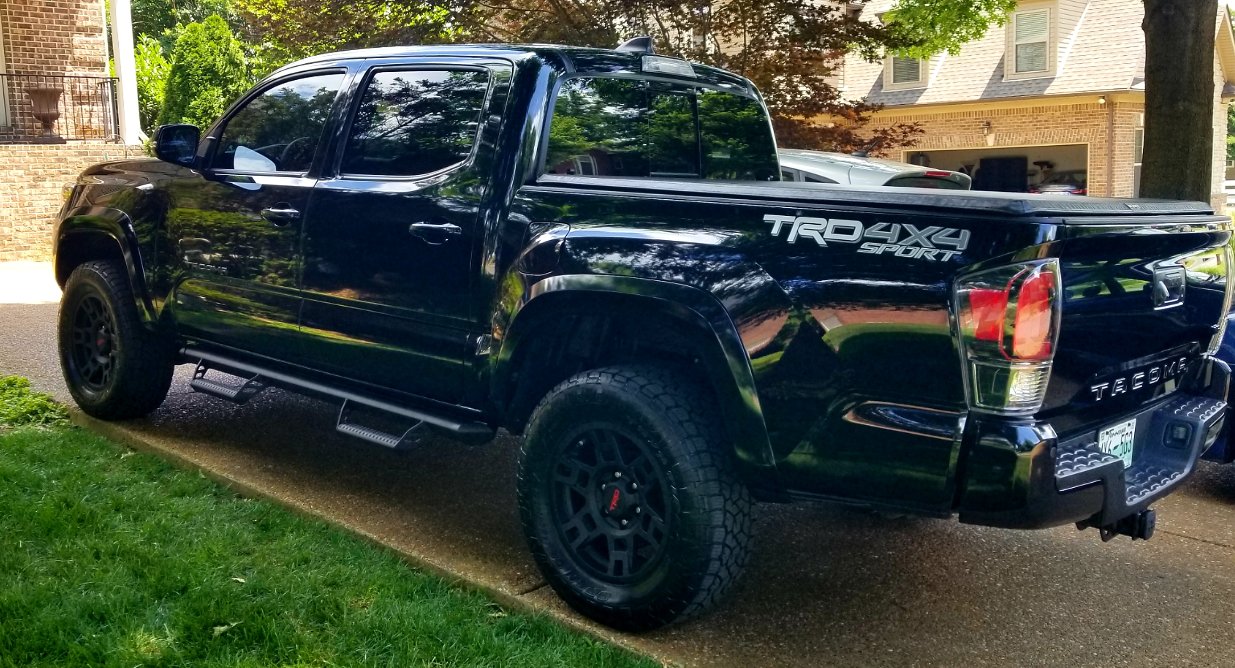

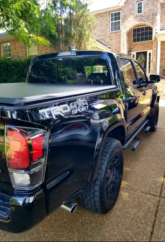

    Stock sport wheels have a 30mm offset. The OEM SEMA style wheel that I just put on my 2020 Sport has a 4mm offset. You can definitely tell the difference. Going to a -10mm is going to really push the tire out away from the truck. I kept tire size at stock.

    This shows it even better...

    It would be very close. I definitely did not want to do any surgery on my wheel wells . My goal wasn’t really to put the biggest tires on I could I mostly wanted all-terrain tires with an aggressive stance... and of course something that was going to look good with my new wheels.

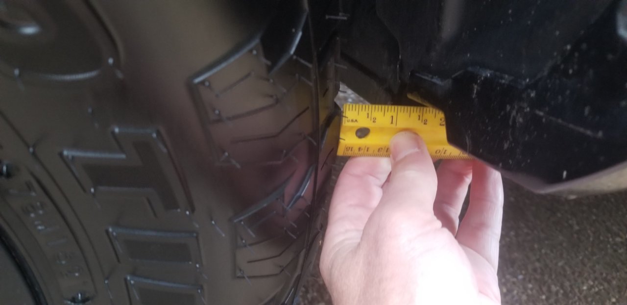

    Follow up on this. I would have just slightly under 1/2" clearance if I had went wtih 70's. So if I were to turn the wheel any, it might get closer. I realize this isn't the best way to measure this. lol. :cheers:

    MIDTNTACO, your truck looks awesome! I have a 22 TRD Sport 4x4 and am looking to do the same. Don't want any rubbing of course. Your info is greatly appreciated! What kind of tires did you go with?
