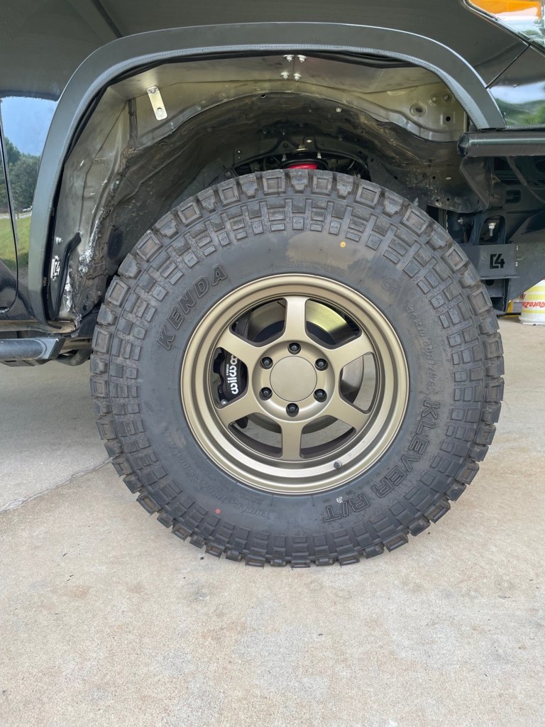

    Not the tire (i.e. KM3) but the tire's width. As long as you go with a high-quality, hub-centric spacer like Bora or Spidertrax you'll be good to go.
    I'm on 17x8 -10 wheels with a 1.25" spacer and 35x10.5 Kenda Klever tires but I wanted a wide stance
