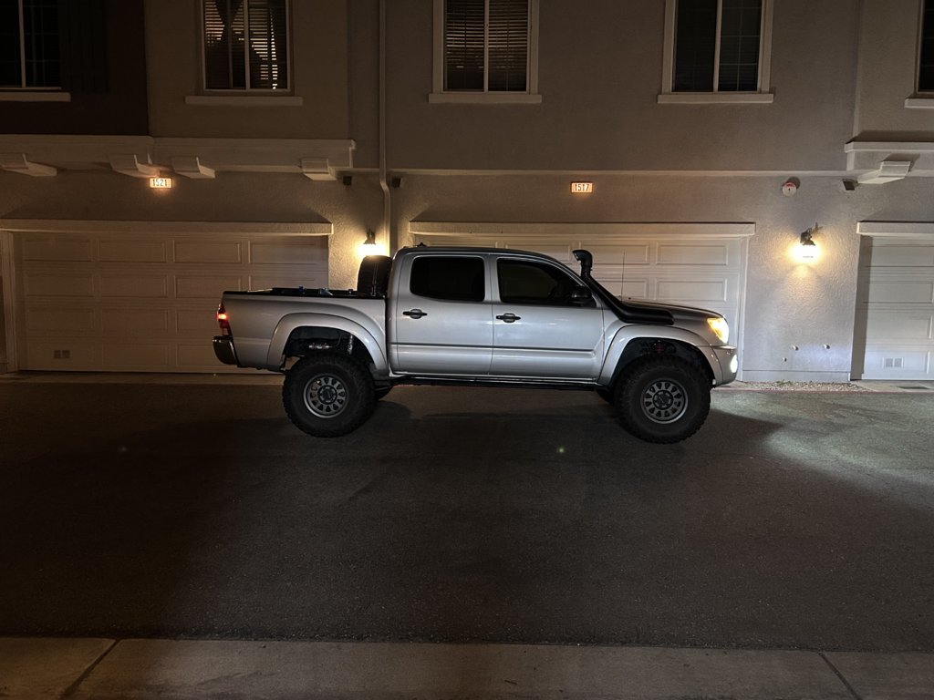

    hell yeah! BTF are neighbors. Considering those but I believe the next hit will be some longfields.IMG_0829.jpg

    It’s not that big a tire and not that hard to fit. If one has funds to flush down the toilet on a turd gen then they can afford that. Things like DRT CMR, fender trim, etc.
    I think I did DRT CMR. Fender delete. UCA and LCA push forward alignment/caster.
    That part on “3rd” gen is probably unchanged ie applicable same requirements.
    you do 37’s and 40’s THEN you start running into questions unlike a Jeep.
    if your cam tabs aren’t already toast then you get the cheaper option of a better fab LCA and reinforcements.
    now that’s a fuckin rig
    That is some desktop background shit.
    get that guy a gofundme we need to get him a SyKlone precleaner NOW
