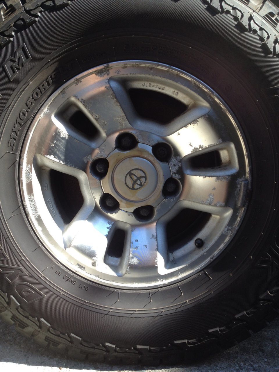

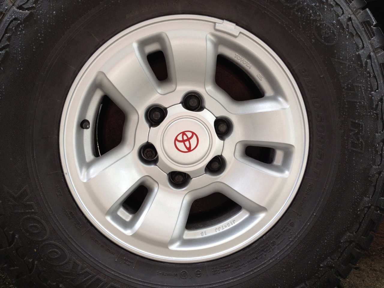

    I used this...
    my wheels went from this..
    to this..
    one year later they still look like new.

    How did you paint the Toyota logo?

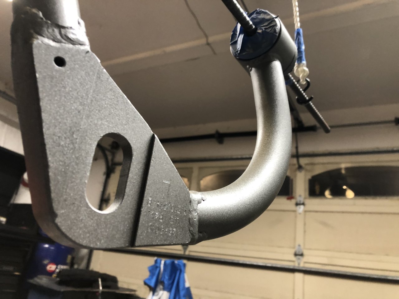

    Unorthodox use for the Duplicolor wheel paint, but I used it for my SPC Upper Control Arms.

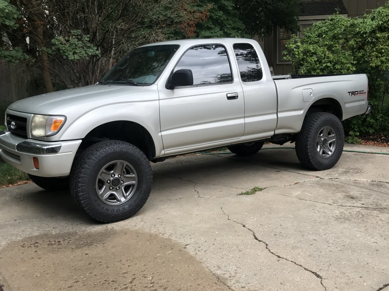

    Just did my FJ wheels that had the usual corrosion
    Grinded with wire wheel,
    sanded,
    primed (rustoleum self-etching x2 coats),
    Painted (rustoleum matte black wheel paint x3 coats
    viola!
