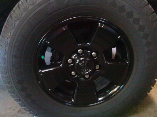

    Materials needed:
    Masking tape
    Newspaper
    Scotch Brite pad
    1 can-Self Etching Primer from O'Reileys
    1 can-Duplicolor High Heat Break Caliper Paint with Ceramic
    1 can-Duplicolor Clear (optional) This will make it gloss black.
    I just taped everything off while on the truck. Takes time, but it's worth it. People always ask me where I bought my wheels!
    1. Clean wheels real good.
    2. Lightly rough the surface up a little, let the scotch brite do the work. Wipe clean. Tack rag is best.
    3. Stuff newspaper in holes of wheels to keep paint from getting on break caliper and inside of wheels.
    4. Spray one coat of self etch primer on each wheel. Then repeat till you have good coverage.
    5. Spray one coat of black on each wheel then wait about 10 minutes and repeat for 2nd coat. Wait 10 min. then apply a third coat.
    6. You can spray clear if you want. It will make it pretty glossy though. Also the clear will give it more protection.
    7. Wait about 45min to an hour before driving.
    I didn't clear mine, and they've been on there for a year and a half with no signs of chips or fading at all. This stuff is really strong and durable.

    Really? painting them on the vehicle. White one as well.. Change "stuff paper into holes" to "take off wheels". I've got overspray on everything in my vicinity. IT'll come off easy enough, but why?
    Also, take off the valve stems and air em down, the tire peals a tiny bit away from the rim so you can stick some tape right under the wheel to get the best coverage.
    Of course, needs to be redone when you get the tires replaced.

    I know that taking off the tires is a much better option, but not everyone can be without their vehicle for that amount of time or has the money to pay a tire shop to do that. This is mod is for those "other" people like me. If you really take your time and tape everything correctly, it can be done in just a few hours and look really good. This is a great alternative to spending thousands on new wheels. The caliper paint is much more durable than high heat engine paint and doesn't chip easy. I bought a new set of black and chrome wheels a few years ago and the first winter they were exposed to, the road salt and crap reaped havoc on the finish. After the caliper paint on my taco wheels and over a year later they still look the same as the day I painted them.

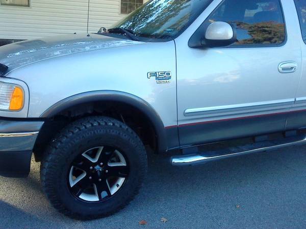

    I used one can of primer and one can of black. Here's a ford wheel I did in two-tone[​IMG]
