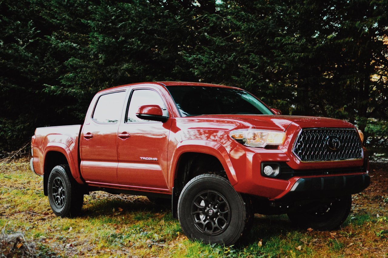

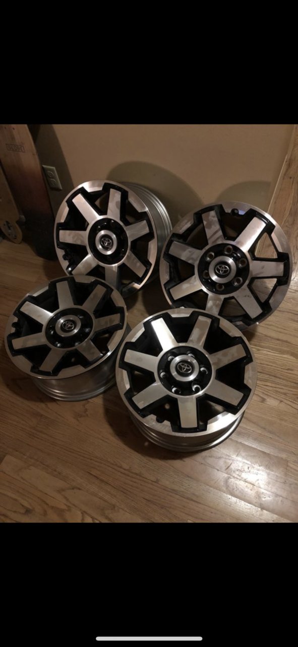

    00AB71FE-CF10-478A-B48A-1CF020CF5BC5.jpg 16921E26-8E1F-456E-844C-DBF5822F04E5.jpg Looking to paint a set of 4Runner TRD off road wheels that I bought used to put on my Tacoma! Looking for some input on the best brand for wheel paint and trying to decide if I want to paint them bronze, or gunmetal gray! Let me know what you all have done. I’ve got a Barcelona Red Tacoma that is leveled and will be putting 275/70s on it this week, so hoping to get this wheel thing figured out ASAP!

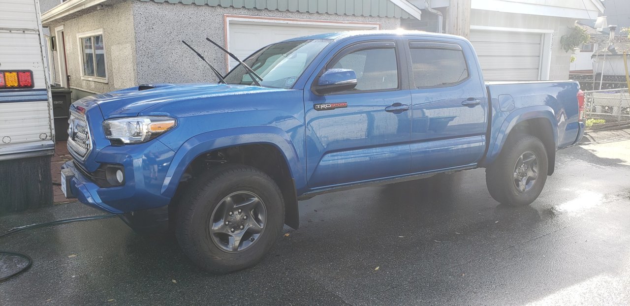

    I painted my motorhome rims and my winter rims with rattle can. I sand blasted them, wiped down with a high quality paint prep degreaser, primed with self etching primer and then painted with multiple coats of Duplicolor wheel paint. Very happy with how they turned out. Prep is the key to a quality looking finish.

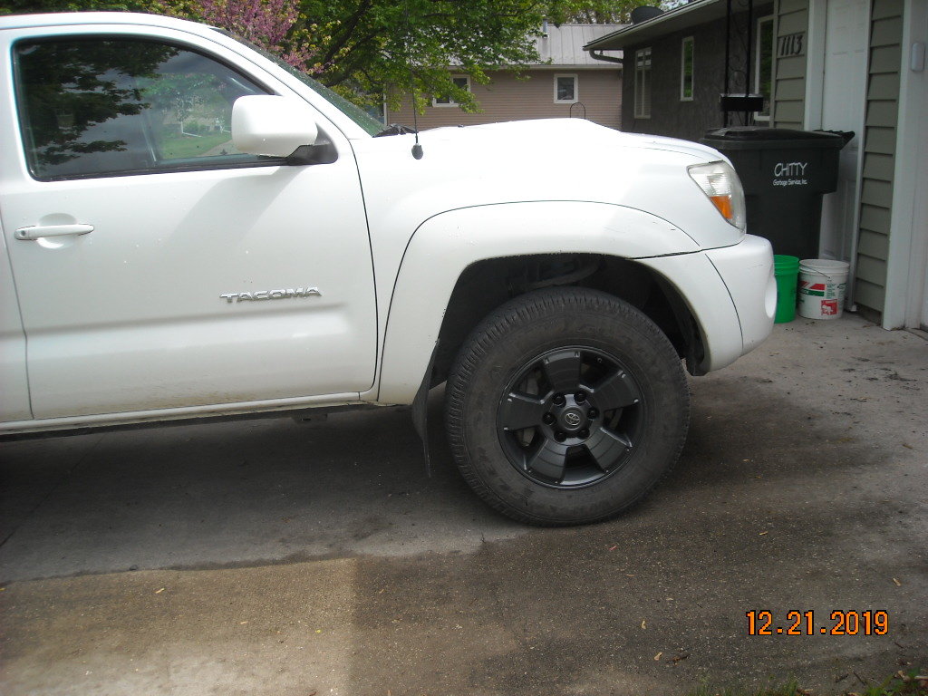

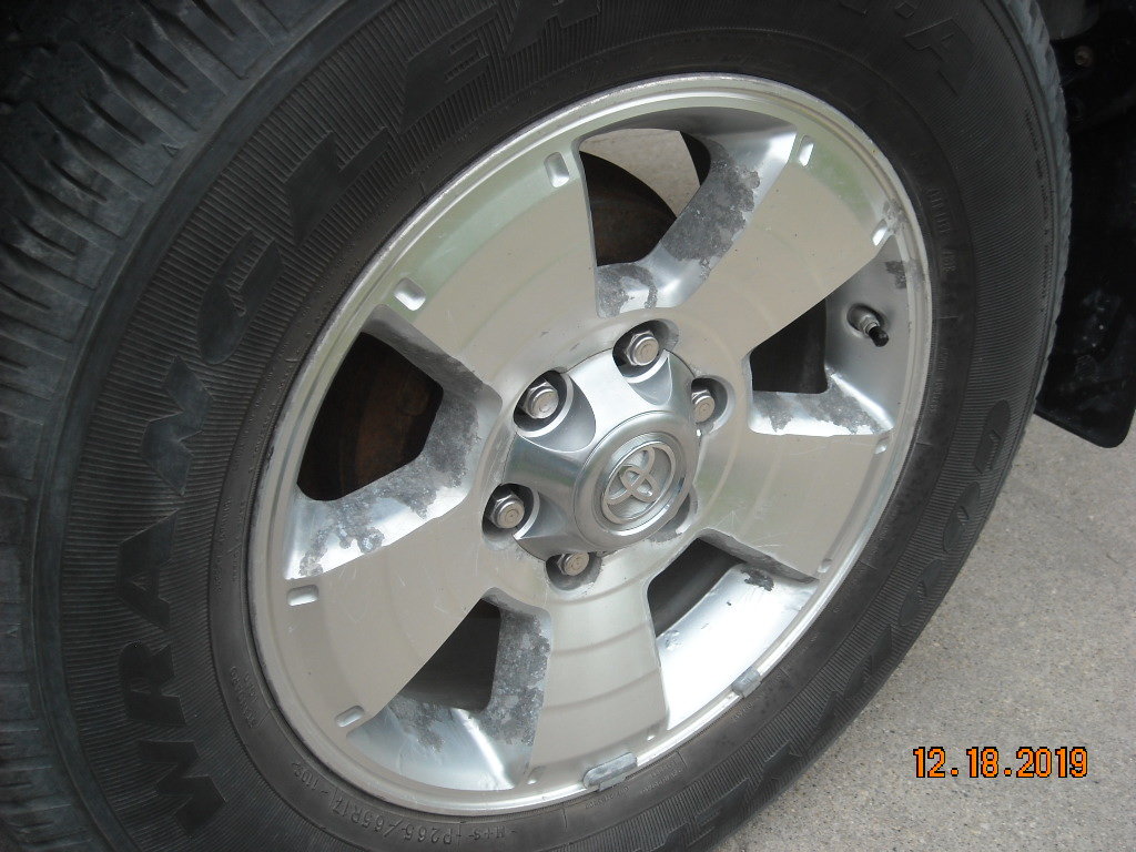

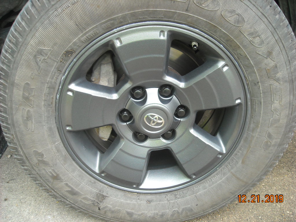

    Before....
    After.....
    Full strip and prep. Used Sherwin-Williams 2K Urethane Automotive paint. Black primer, Gunmetal color, Satin Clear. 2 coats of each.

    Did you do a chemical strip or just sand them down?
  11. Jul 2, 2021 at 8:00 PM
    Knute
    Knute Well-Known Member
    Aug 13, 2020
    #337515
    5,149
    '06 4.0L Tacoma TRD Sport
    Stock, 4WD, Access Cab, White,
    Tried Chemical, specifically Aircraft Stripper, wouldn't touch it.
    Used wire wheels on 4.5" small angle grinder and drill. Final prep was 180 grit AlO2 paper. Final clean with Acetone.
    All work done on bare wheels, no rubber, no weights, no TPMS.
    BTW, the Toyota OEM paint is tough stuff. Each wheel took 5-6 hours to strip. All surfaces.

    The paint on my wheels was allowed to "cure" for 2 weeks before the rubber was installed. The local Toyota shop did the work. Zero (0), NADA, zilch damage to the paint. If you look close at the picture (about 10:00 o'clock position), there is a white schmear on the outer edge. This is not primer, the schmear is the lube the shop used during install. The balance weights are the stick on type on the inside of the rim, in line with the wheel centerline. The tech who did the work for the mount, TPMS, balance did a superb job on the balance.

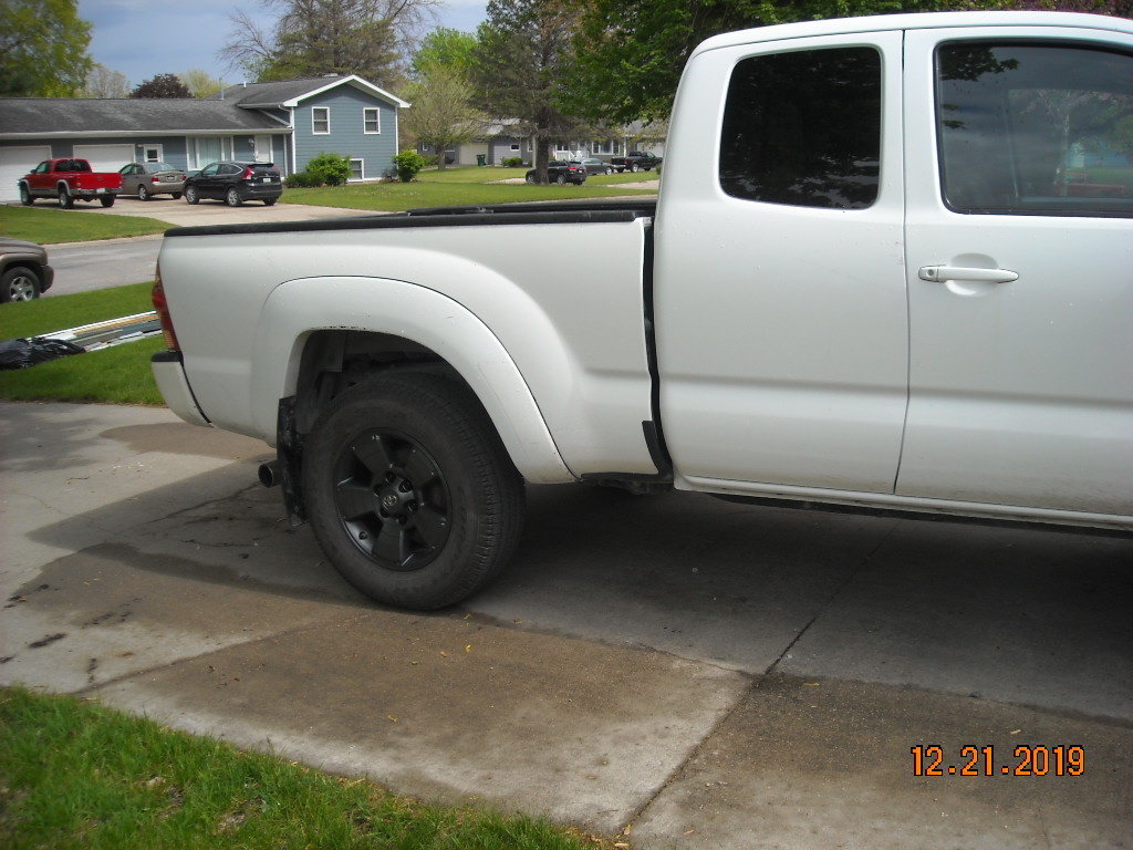

    On truck......

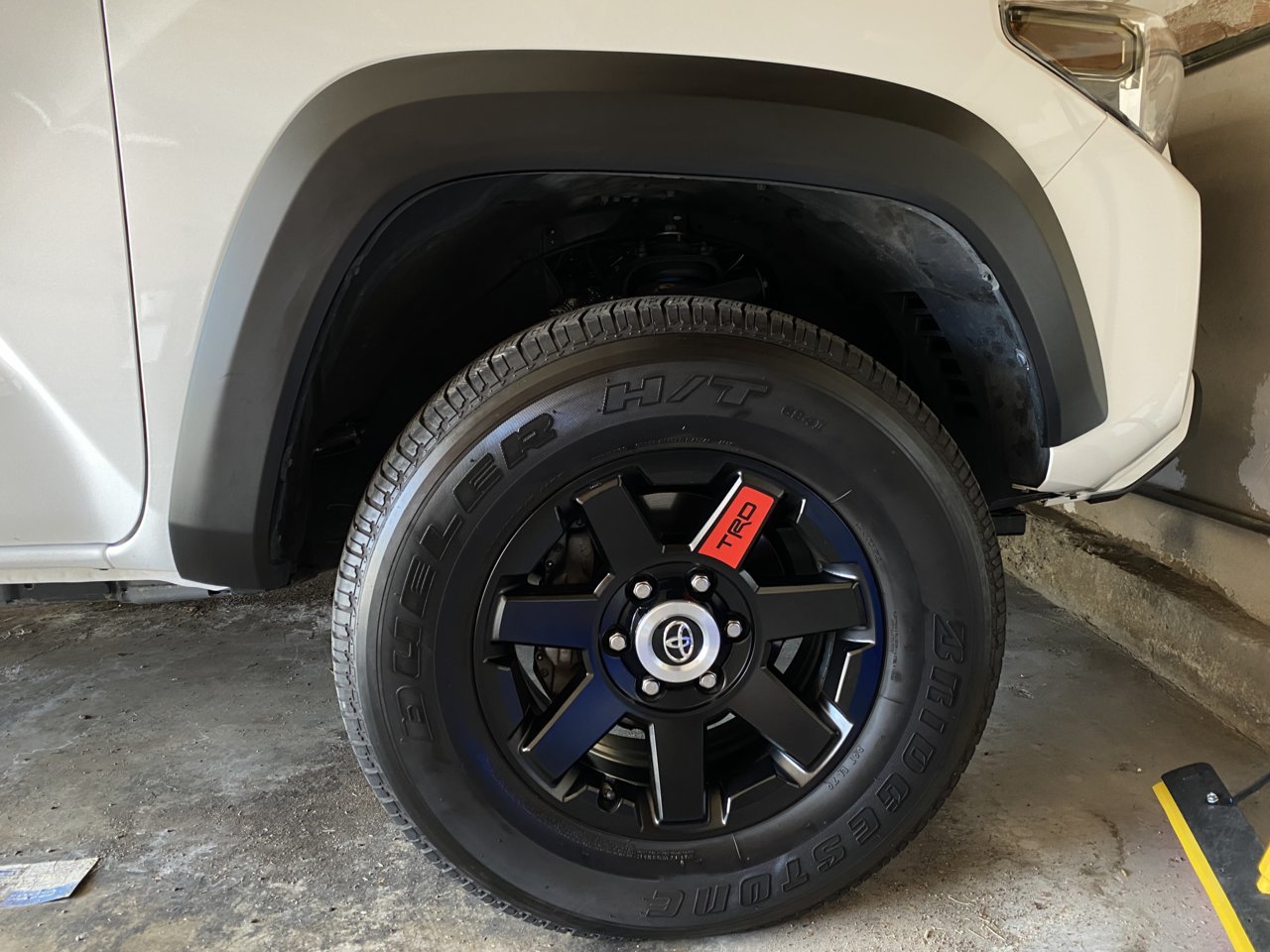

    Here’s how the 4Runner wheels look like powder coated matte black for your reference. It ended up being just under $500 for the coating IIRC.
