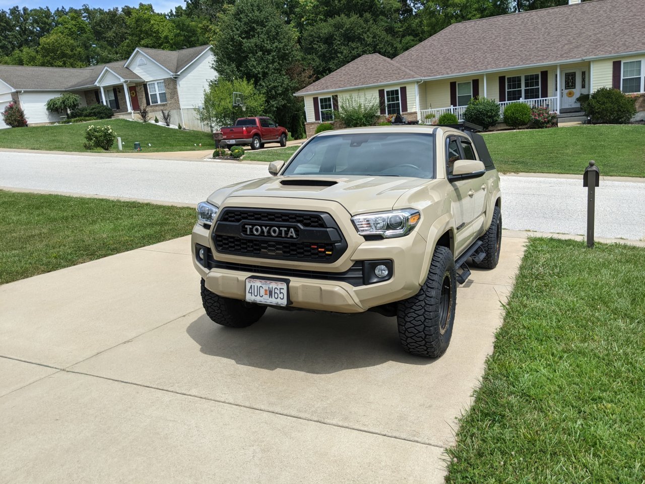

    SCS 17x8.5 -10 offset. 285/70/17. Iron Man Foamcell Pro stage 2 set at 2.5". 4.88 gears. Rear E-locker. KDMax Tuned
    I've got basically the same specs except -10 offset. These are the only pics I got right now but I think it's about perfect PXL_20210813_190126556.jpg PXL_20210813_190100684.jpg

    Looks perfect! By seeing this that makes me feel the extra 2mm on mine should be fine. Thanks and sweet setup!

    That looks WAY more than 1/2” to me.
    My 7.5” +10 wheels I feel stuck out about a half inch with 265 tires.

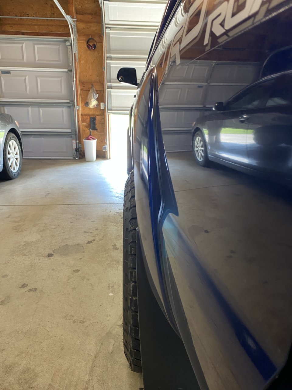

    Here are mine to give you and idea. You have another half inch of backspacing and wheel so you’ll be sticking out more than me. Apologies for not matching completely, hoping I can help.
    16 X 8 6 X 139.7 4.00" -12mm 22 lb 3 oz

    Thats a good look. I might look at -6mm offset with the 4.5 backspacing. Im kinda worried -12mm might stick out a tad further than I want. -12mm looks good but want to avoid tickets where I live and kicking to many rocks on paint.
